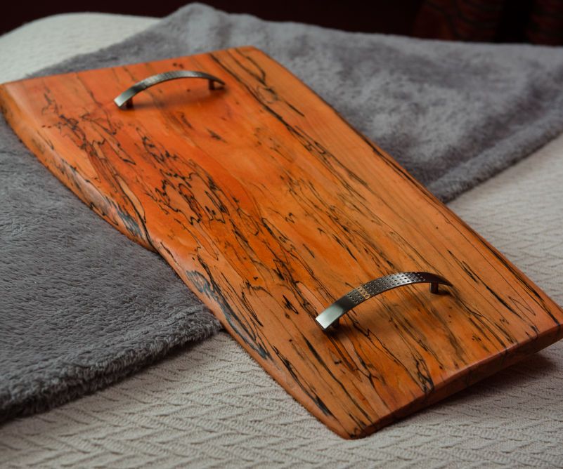

Okay, now its time to prep the dye. You can get FolkArt dye in an array of different colors. All of them are pretty bold and bright. You may choose to take one of their colors and use-as-is. One of my favorites to use-as-is is the teal. You may also choose to do a little mixing of a couple or many of the colors to come up with your own hue. It is completely up to you. Either way, you will want to put your dye into one of your disposable cups. If you are mixing multiple colors together you will want to use a disposable stir stick.
Now the next thing you need to determine is whether to thin it with water or not. If you apply as is, without thinning, you will absolutely still be able to see the grain of the wood. However, like I have stated, the colors are very bold, and because of that, they can distract from the grain pattern. So, if I have a piece of wood that has some very unique grain patterns, such as a piece of spalted wood, I usually decide to thin the dye down with water, just so the color adds to the pattern of the grain, not distract from it. To thin it, just add water to the dye in the cup and mix.

Lay down a piece of cardboard on the table you will be using to dye your project. The piece should be big enough for the piece you are dying along with the cup of dye and the cotton rags. Place your piece of wood, your cup of dye, and your cotton rags on the cardboard. You will want at least two cotton rags. Put on a pair of Nitrile gloves to keep from dying your hands. With one cotton rag, dip it in the dye and apply it to your piece of wood. I like to apply the dye using a circular motion with the rag. Apply the dye to all surfaces of the wood you would like to color. With the clean rag, remove any excess dye from the wood. Leave your wood piece on the cardboard to dry. Let the piece dry for at least two hours before applying any additional finish.
