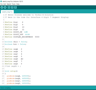

Step 4: ARDUINO CODE
Make a circuit & Upload following code to Arduino Uno.
