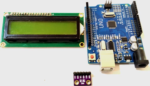

The BMP280 sensor module can be used with microcontrollers such as Arduino, PIC, AVR, etc. For this project we will use Arduino Uno and BMP280 along with LCD 16x2 display module to display temperature and pressure values. Before connecting the BMP280 with Arduino, we need to download the BMP280 Arduino library developed by Adafruit.
  • Arduino
  • BMP280
  • Connect wires
  • Breadboard
  • LCD monitor - 16x2

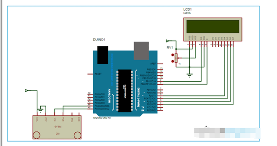

Step 2: Circuit Diagram Connecting BMP280 to Arduino
The circuit diagram for connecting Arduino with BMP280 sensor and LCD is shown below.
The VCC and GND pins of the sensor are connected to the 3v3 and GND pins of the Arduino. The SCL and SDA pins of the sensor are connected to A5 and A4 of the Arduino board.
