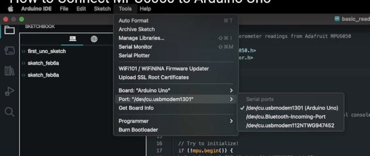

For the sake of this tutorial, I assume you already know how to connect to the Arduino UNO in the Arduino IDE, and of course, you have the Arduino IDE installed.
  • Connect to the board as follows (in the diagram), by going to the Tools tab and selecting the correct Board and Port.

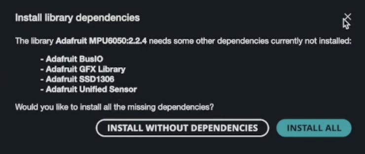

  • Install the Adafruit MPU6050 library with all corresponding dependencies
You can find the library manager on the left side of the Arduino IDE.

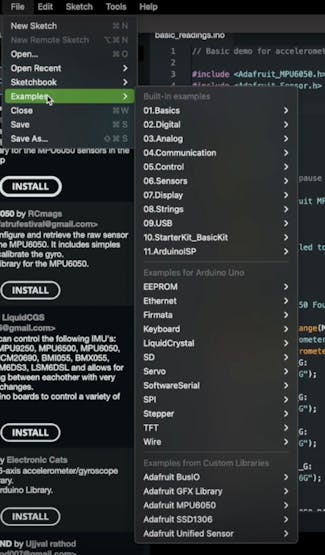

  • The code is easy, thankfully the library itself comes with a full-fledged example. Go to the File tab and go to Examples, scroll to Adafruit MPU6050
Select the basic_readings.ino and upload it to Arduino with the upload button.

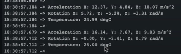

If you did everything correctly you will get readings as follows:
