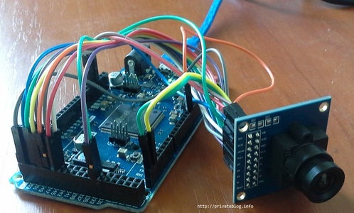

Step 1: Schema to Connect OV7670 to Arduino Due
Let's start from connecting wires. Schema is available on the picture. You do not need any resistors. Operation voltage on Arduino Due is 3V. It is optimal for OV7670.
