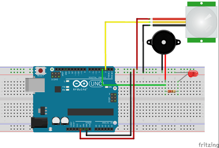

Step 2: Circuit Diagram and Description
The image below shows the circuit diagram of arduino motion detector project to interface Arduino with PIR module and blink LED/buzzer.
We use the 5V power rail from the Arduino to power the PIR sensor. The output pin of the PIR sensor is connected to the 2 digital pins of the Arduino. This pin will be the input pin of the Arduino. Then there are 3^RD^ pins of the Arduino connected to the LED and buzzer. This pin will act as the output pin of the Arduino. We will program the Arduino to trigger the output on the 3^RD^ pin if an input of 2 is detected on the ^DE·^ pin. The complete procedure is explained below.

The circuit and program of this arduino motion detector has been discussed above. Now you can build this circuit on the breadboard as per the schematic given above and upload the program at the end of this tutorial. Once connected, your settings should look like below.
Now, power on the Arduino and wait for about 50-60 seconds for the PIR sensor to calibrate. Don't be frustrated by the output you get during this period. After that, try moving in front of the PIR sensor and your LED/buzzer should be triggered.
