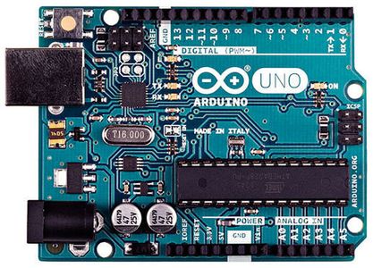

- connect he vcc to 5v of arduino .
- connect the ground wire to Gnd of arduino uno board.
- connect the control pin of servo motor to the pin no. 9 of arduino uno board.
