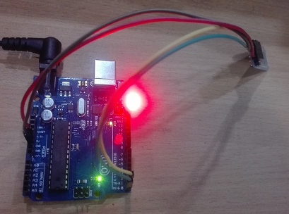

In this project, we connected the Mercury switch/tilt sensor to the Arduino UNO development board. Then depending on the output of the tilt sensor, we control the LED and buzzer. Whenever we tilt the sensor, the alarm will turn on.

To connect the tilt sensor to the Arduino development board, we need a 5v DC power supply to work. This 5v is provided using the Arduino UNO, and the output of the tilt sensor is connected to pin 4 of the Arduino. The LED is connected to Pin 2 of the Arduino UNO via a 220 ohm resistor to limit the current to a safe value. And, the buzzer is connected directly to PIN 3 of the Arduino UNO.

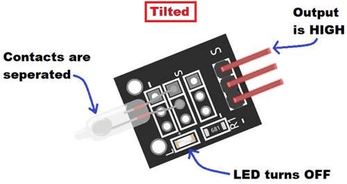

This is a Mercury switch based tilt sensor module that provides a high level at its output pins when tilted. It requires a 5V DC input. It is a three-terminal device consisting of an input, a ground and an output. It has a glass tube consisting of two electrodes and a liquid mercury sphere. The liquid mercury bulb closes as well as opens the circuit when it is tilted in a specific direction. The working and internal structure of the module is as follows:

Step 4: The Working Process of the Tilt Sensor (tilt)
When it is tilted in a specific direction or angle, the liquid mercury breaks the contact between the metal electrodes and opens the circuit. Therefore, we output a high level in this case and the on-board LED goes out.
