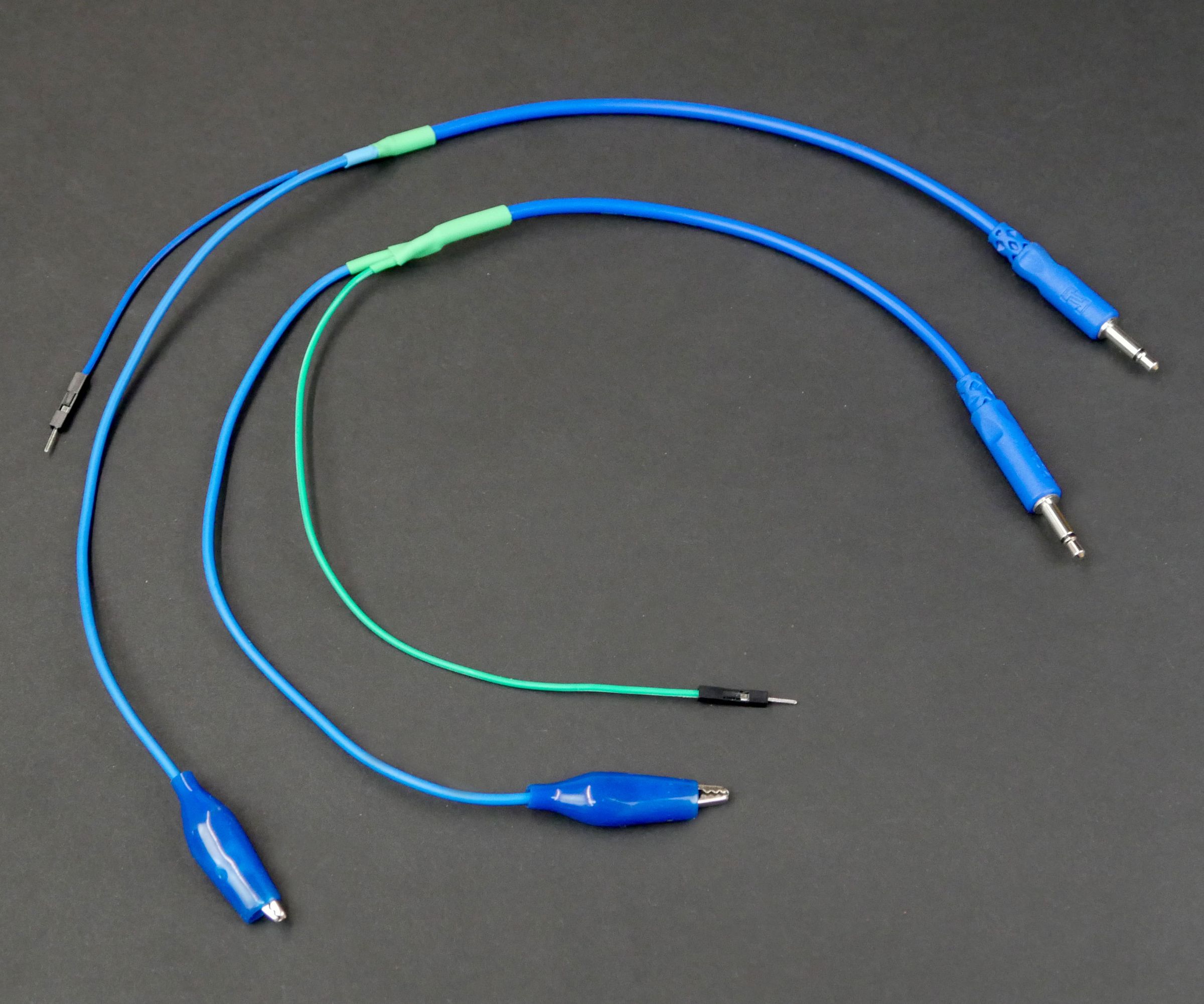

Eurorack patch cables are 3.5mm TS (tip, sleeve) cable. The tip is the signal the sleeve is ground. The female header patch on the Werkstatt only provides an input or output of signal so we need to find a ground to connect to, creating a signal to signal, ground to ground connection. To do this we will add a ground wire and create a custom cable to connect to it and the header patch bay with.

Step 5: Create Cable With Alligator, Male Header and 3.5mm Plug
This cable is simple and easy to whip up. All you need are the connectors and leads. There are different ways to do this as shown in the video from step 1.
After you create this cable and add the grounding wire you are ready to take CV in and outs using a 3.5mm plug!
