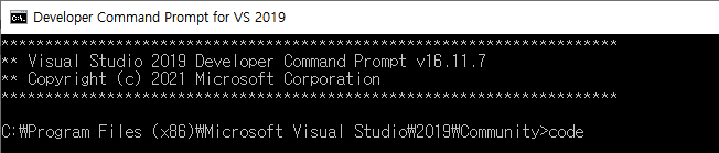

To use Visual Studio’s build environment, run VS Code through the Developer Command Prompt for VS 2019 as follows:
This will open Visual Studio Code with all the correct environment variables set so that the toolchain is correctly configured.

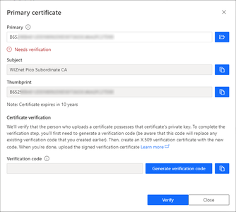

Proof of possession (verify certificate)
Register subca.crt to IoT Central.

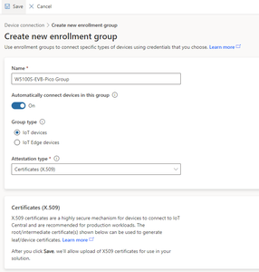

Register IoT Central group
Click the new button → Create a new enrollment group
  • Name: Specify an identifiable name
  • Attestation type: Certificates (X.509)
If you click the Save button to save, the screen to register the certificate appears.

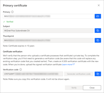

After clicking the ‘Manage primary’ button, click the folder-shaped icon to upload the certificate.
Upload subca.crt
Click the Generate verification code button to generate and copy the verification code.
Generate a verify certificate using openssl. Enter the generated verification code at this time.
~/subca$ openssl genpkey -out pop.key -algorithm RSA -pkeyopt rsa_keygen_bits:2048
~/subca$ openssl req -new -key pop.key -out pop.csr
**Paste the verification code into Common Name
~/subca$ openssl ca -config subca.conf -in pop.csr -out pop.crt -extensions client_ext
After clicking the ‘Verify’ button, select the generated verify certificate from the file selection pop-up window that appears.
If you can’t see the files, select the option to view all files
When the proof of ownership is completed, the status is changed to Verified as shown image.

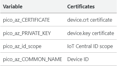

The generated device certificate must be added as a variable to sample_certs.c.
The variables to use to connect with IoT Central X.509 certificate authentication are as follows the image.
For pico_az_COMMON_NAME, use the same value as the Common Name written when creating the device certificate.

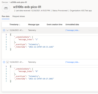

Check the device created in IoT Central
  • Check the device creation on IoT Central
  • Check the sample data sent from the example code

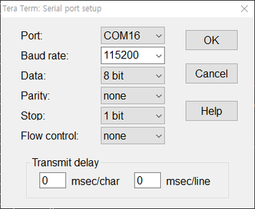

Device operation status can be monitored using terminal programs such as Terra Term or Putty.
Check the COM port number corresponding to W5100S-EVB-Pico in Windows Device Manager, and connect by setting the corresponding port in the terminal program.
In the case of Terra Term, you can connect by setting as following images.
