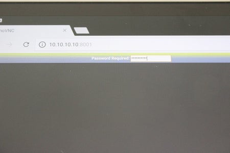

Step 3: Connect Wirelessly
4. Connect your tablet to “dex” over wifi. You should be able to find it in the list of available wifi SSID on your tablet.
5. In your browser, enter “http://10.10.10.10” with your keyboard.
6. Select noVNC and Login! The standard password is “robots1234”
