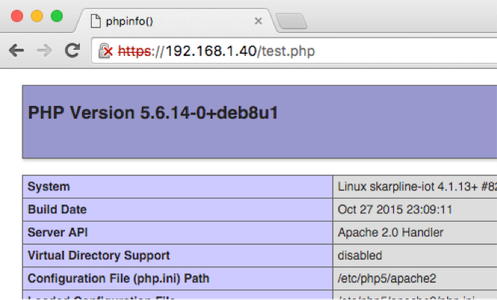

Now type http://192.168.1.40/test.php
We’re getting there, but we’re not done yet. Now enable SSL:
rpi_admin@skarpline-iot:/var/www/html $ sudo a2enmod ssl rpi_admin@skarpline-iot:/var/www/html $ sudo service apache2 restart rpi_admin@skarpline-iot:/var/www/html $ sudo a2ensite default-ssl
Now type https://192.168.1.40/test.php
Fantastic – now we’re talking! If this were hardware, now would be the time to lift your hands and slowly step away from the table.
Why the warning in the browser? It’s merely the browser telling you, that the certificate is not an official certificate and therefore not trusted. You will always get this error when accessing an IP address, since the certificate is bound to the FQDN (Fully Qualified Domain Name) of the site. In our case even using the FQDN you’d still get the error, since we’re using a locally signed (self signed) certificate.
If you get this kind of warning when using net banking, I recommend that you stop what you’re doing!
I choose to don’t care, since for our purpose it’s fine. A commercial product is of course another matter. You can get free certificates many places, e.g. here: : https://www.sslshopper.com/article-free-ssl-certi...
We accept the risk in the browser, and are now able to access the webpage via HTTPS:
