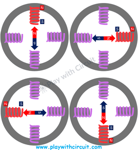

Stepper motors are a type of brushless DC electric motor that divides a full rotation into a number of equal steps. They are known for their ability to position precisely and repeatedly without the need for feedback systems. Each step moves the motor a fixed increment, allowing for precise control of angular position. Stepper motors are widely used in applications requiring precise motion control, such as 3D printers, CNC machines, and robotics.
A stepper motor operates by energizing a sequence of coils in a specific order, which creates a rotating magnetic field. The rotor, which is a permanent magnet or contains a magnetic material, follows this rotating magnetic field, resulting in a stepwise movement.
Modes of Operation in Stepper Motor
Full Step Mode (Single Phase ON) or Wave Stepping
In Full Step Mode (Single Phase ON), only one coil is energized at a time. This mode offers less torque but consumes less power and generates less heat. It’s suitable for applications where precision and smoothness of motion are not critical.
Full Step Mode (Two Phase ON)
In this mode, two coils are energized simultaneously, producing higher torque compared to the Single Phase ON mode. This mode is preferred in applications where torque is more critical than power consumption.
Half Step Mode
Half Step Mode alternates between energizing one coil and two coils. This effectively doubles the number of steps per revolution, resulting in smoother motion and higher resolution. However, the torque in half step mode is slightly lower than in the Full Step (Two Phase ON) mode.
Microstepping Mode
Microstepping divides each step into smaller steps by controlling the current through the coils with high precision. This mode provides the smoothest motion and highest resolution, but it requires more sophisticated control and generates more heat.

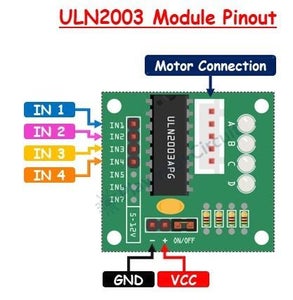

Step 3: Understanding ULN2003 Stepper Motor Driver Module
The ULN2003 stepper motor driver module is an essential component for controlling the 28BYJ-48 stepper motor. This module simplifies the process of interfacing the stepper motor with a microcontroller like the Arduino.
ULN2003 Module Pinout
The ULN2003 module has a series of input pins, output pins, and power connections:
  1. IN1, IN2, IN3, IN4: Control inputs for the coils of the stepper motor.
  2. OUT1, OUT2, OUT3, OUT4: Outputs connected to the stepper motor coils.
  3. GND: Ground connection.
  4. VCC: Power supply connection (usually 5V).
Step 4: Interfacing 28BYJ-48 Stepper Motor With Arduino Uno
Now, let’s interface the 28BYJ-48 stepper motor with an Arduino Uno using the ULN2003 driver module. To begin, connect the 28BYJ-48 stepper motor to the ULN2003 driver module. The motor comes with a 5-wire connector that plugs directly into the ULN2003 module.
Pin Connections between ULN2003 Driver and Arduino Uno
Next, connect the ULN2003 module to the Arduino Uno:
ULN2003 IN1 to Arduino Digital Pin 7
ULN2003 IN2 to Arduino Digital Pin 6
ULN2003 IN3 to Arduino Digital Pin 5
ULN2003 IN4 to Arduino Digital Pin 4
ULN2003 GND to Arduino GND
ULN2003 VCC to Arduino 5V
