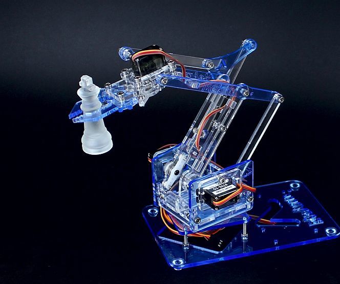

In this project I set myself the task of controlling the movement of 3 servo motors by pressing push button switches. My intention is to use these buttons to control the motion of a three-servo robot arm.
What I want to happen:
1. I want to control a servo using a pair of buttons, one to turn it clockwise, one to turn it counter-clockwise
2. If you press and hold down a button, a servo motor will move clockwise until it reaches its maximum limit.
3. If you push and hold down the other button, a servo motor will move counter-clockwise until it reaches its maximum limit.
3. If you tap a button and release it, a servo motor will move a set amount in a particular direction.
4. When you first switch on the Arduino, the servo will reset its position to the middle of its arc of movement
Things I had to be careful of:
1. Trying to force the servo motor to keep moving in one direction, after it has reached its maximum limit, could damage it.
2. Attaching too many servos to the Arduino's 5v power-line could damage the components on the Ardiuno, so I need to power the servo motors externally.
3. Getting tied up with all these cables! I need to be able to extend their length to increase flexibility of positioning and to tidy the cables out of the way of the buttons.
