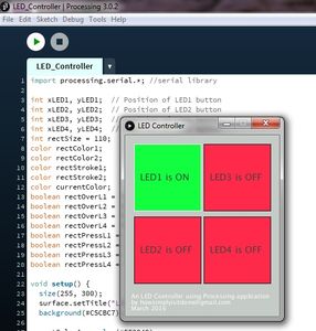

Basically the sketch created four squares and texts.

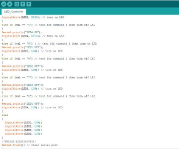

Each boxes wait for mouseClicked() being issued against the specific boxes and would send data serially base on the existing GizDuino sketch:
1 = LED1 ON, 5 = LED1 OFF
2 = LED2 ON, 6 = LED2 OFF 3 = LED3 ON, 7 = LED3 OFF 4 = LED4 ON, 8 = LED4 OFF
The working application was attached. Source code may be requested through howsimplyisitdone@gmail.com

Step 2: GizDuino Sketch
The same sketch will be used for our GizDuino sketch as attached.
