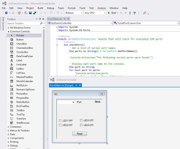

Step 2: Visual Basic Application
This step assumes prior knowledge in basic VB to proceed with the steps.
The application uses the following:
1 ComboBox to specify the PORT to used for serial communication,
2. CheckBox to turn the LEDs ON and OFF
3. CommandButton to reset the CheckBox.
4. Labels for the texts.
Refer to the attached application.
Note: When writing to serial port, I had to iterate on the write command so that GizDuino will be able to read it.

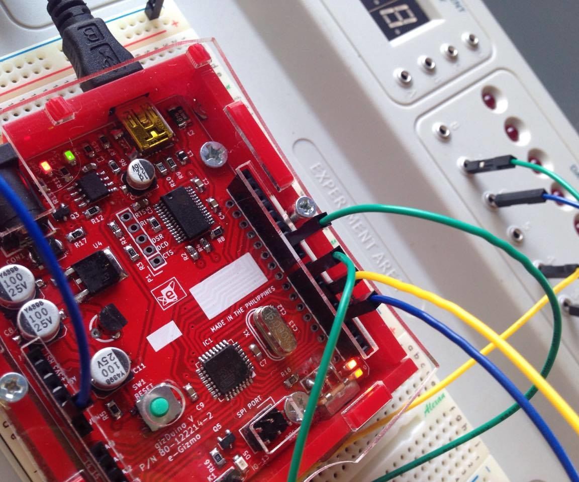

Step 3: Wiring of the External Circuit
The circuit is composed of 4 LEDs and resistors, and connecting wires.
Port 3, 5, 7 and 9 have been used as output ports in GizDuino and each forms a series array.
