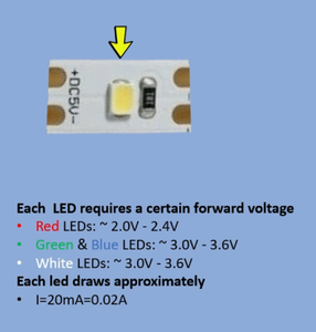

Step 1: How LED Strips Work – 5V Vs 12V
Single-color LED strips are made up of repeatable segments, each containing LEDs and a resistor. These segments are separated by clearly marked cut lines, allowing you to trim the strip to any length — as long as you cut only along those designated points. These marks are present on both 5V and 12V strips and usually appear as small copper pads or scissor icons.

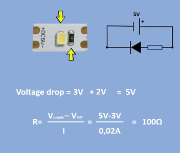

🔋 5V LED Strips
In a 5V LED strip, each segment typically includes one LED + one resistor wired in series. Multiple such segments are then connected in parallel along the strip.
📊 Current per segment: ~20 mA
📊 Voltage drop per segment: ~3V (LED) + ~2V (resistor) = 5V
📏 Resistor calculation:
R = (V_supply - V_LED) / I
R = (5V - 3V) / 0.02A = 100Ω
💡 Total current = 20 mA × number of segments
This means power requirements increase linearly with the number of segments. Make sure your power supply can supply required current
