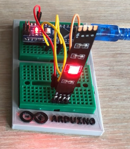

Step 2: Wiring a Single RGB LED Segment to the Arduino
To begin, we’ll power just one segment of the RGB LED strip directly from the Arduino. This works because each channel only draws ~20mA, which is safe for a single pin.
🔌 Connections:
  1. 5V pad → Arduino 5V
  2. R pad → Arduino D6
  3. G pad → Arduino D9
  4. B pad → Arduino D3
🧠 Be aware: pad labels may be incorrect on cheaper strips. If color channels don’t behave as expected, swap pin assignments in code to match reality.

Step 5: Controlling Longer RGB Strips With MOSFETs and External Power
When you're ready to move beyond a single RGB segment, powering a longer strip directly from Arduino pins is no longer safe. Each additional LED segment increases current demand, and Arduino’s I/O pins can only safely supply ~20 mA per pin — not nearly enough for a full RGB strip.
To solve this, we’ll use MOSFETs to switch higher currents from an external 5V or 12V power supply, while still using Arduino to control color and brightness with PWM.
🔧 How It Works
Each RGB channel (Red, Green, Blue) gets its own N-channel logic-level MOSFET, which switches that color's negative line (the R, G, or B pad) to GND. The Arduino sends a PWM signal to the gate of each MOSFET to control brightness.
🛠️ Wiring Overview:
🔌 Power:
  1. Power Supply +V → RGB strip 5V (or 12V) pad
  2. Power Supply GND → MOSFET source pins and Arduino GND
🟢 Red Channel (example):
  1. MOSFET Drain → R pad on LED strip
  2. MOSFET Source → GND
  3. Gate → Arduino pin 6 via 220Ω resistor
  4. Gate also → GND via 10kΩ pull-down resistor
Repeat the same structure for:
  1. Green → Arduino pin 3
  2. Blue → Arduino pin 9
🧠 This time, we are not inverting the PWM signal, because the MOSFET turns the strip’s color pads on/off with a HIGH signal, not LOW like before with direct control.
