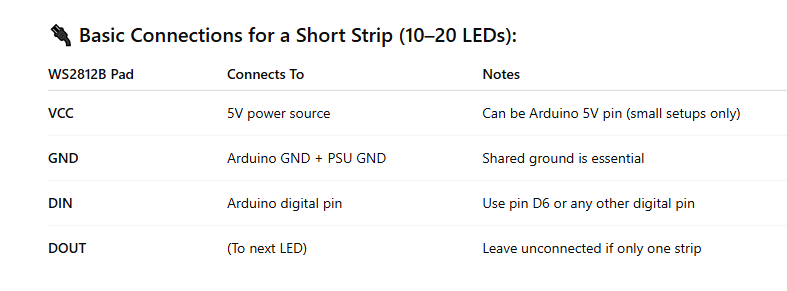

Step 2: Wiring a WS2812B Strip to an Arduino

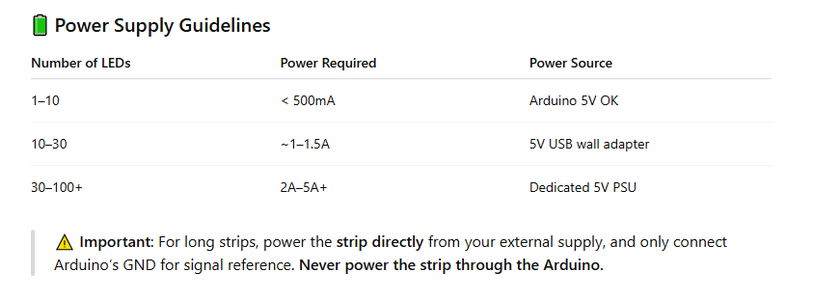

Wiring WS2812B LEDs is simpler than RGB strips — just one signal pin and two power lines — but getting it wrong can damage your LEDs or Arduino. Let’s do it right.
🔐 Best Practice Add-ons
To protect your LEDs and Arduino:
  1. 220Ω resistor between Arduino pin and DIN → prevents voltage spikes
  2. 1000µF capacitor across VCC and GND at strip input → stabilizes power
  3. Always power off before connecting/disconnecting the strip
✅ Example for 10 LEDs and Arduino Nano:
  1. VCC → Nano 5V
  2. GND → Nano GND
  3. DIN → D6 with a 220Ω resistor inline
  4. Optional: 1000µF cap between VCC and GND
