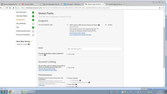

Step 10: On Next Page It Will Ask Two Option for End Point One Is AWS and HTTPS
Select HTTPS & save it and move to next page.
Step 11: For SSL Certificate Choose Second Option. Save It and Move to Next Page.
