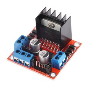

Step 3: The Circuit
  • Connect Power supply (batteries) pin (gnd) to motor driver controler pin (gnd)
  • Connect Power supply (batteries) pin (+) to motor driver controler pin (+)
  • Connect Power supply (batteries) pin (+) to Arduino pin (VIN)
  • Connect GND from Arduino to motor driver controler pin (gnd)
  • Connect digital pin(6) from Arduino to motor driver pin (IN1)
  • Connect digital pin(8) from Arduino to motor driver pin (IN2)
  • Connect Linear Actuator to the motor driver as you can see on the schematic
  • Connect Capacitive Touch button pin (SIG) to Arduino digital pin (2)
  • Connect Capacitive Touch button pin (VCC) to Arduino pin (5V)
  • Connect Capacitive Touch button pin (GND) to Arduino pin (GND)

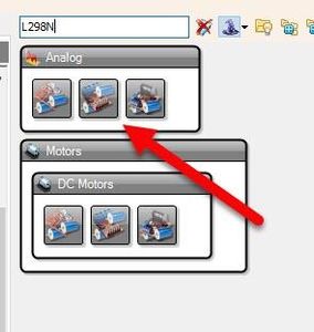

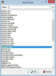

Step 4: Start Visuino, and Select the Arduino UNO Board Type
Start Visuino as shown in the first picture Click on the "Tools" button on the Arduino component (Picture 1) in Visuino When the dialog appears, select "Arduino UNO" as shown on Picture 2
Step 5: In Visuino Add & Set Components
  • Add "Debounce Button" component
  • Add "Toggle(T) Flip-Flop" component
  • Add "Speed and Direction To Speed" component
  • Add "L298N" component
  • Select "SpeedAndDirectionToSpeed1" and in the properties window set "Initial Speed" to 1
Step 6: In Visuino Connect Components
  • Connect Arduino digital pin [2] to "Button1" pin [In]
  • Connect "Button1" pin [Out] to "TFlipFlop1" pin [Clock]
  • Connect "TFlipFlop1" pin [Out] to "SpeedAndDirectionToSpeed1" pin [Reversed]
  • Connect "SpeedAndDirectionToSpeed1" pin [Out] to "DualMotorDriver1" > Motors [0] Pin [In]
  • Connect ""DualMotorDriver1" > Motors [0] Pin [Direction]" to Arduino digital pin[8]
  • Connect ""DualMotorDriver1" > Motors [0] Pin [Speed]" to Arduino digital pin Analog PWM[6]

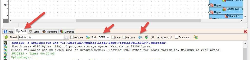

Step 7: Generate, Compile, and Upload the Arduino Code
In Visuino, at the bottom click on the "Build" Tab, make sure the correct port is selected, then click on the "Compile/Build and Upload" button.
