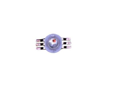

Hello all Electronic enthusiast's!, in this project I will explain how an RGB LED (6pin 3watt) works and how to controll it using Arduino Uno board. The 3 watt RGB LED consumes 1 watt per chanel hence to switch this higher power LED we need an TIP122 transistor.
The RGB LED has three LED's embedded in it with separate cathodes and anodes. Each of them has to be connected to the arduino through three TIP122 transistors. Since it is a 3 watt LED it needs an heat sink to dissipate the heat generated by the led. Warning: do not look directly into this led for more than 5 second's.

  1. 3 watt 6 pin RGB led x 1

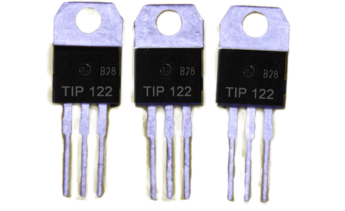

  3. TIP122 transistor x 3

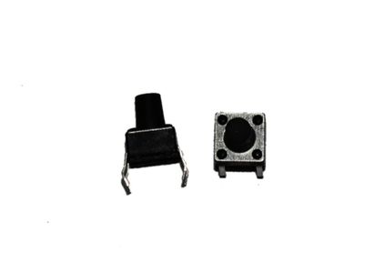

  6. Tactile Switch x 1

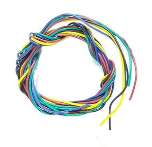

  9. Single stranded wires(less than a meter).

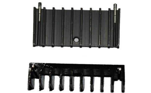

Step 2: Fixing the LED to Heat Sink
Since it is an 3 watt LED, it starts to get hot very soon, hence we use heat sink to dissipate the heat generated by the LED. First add a drop of heat sink paste on the heat sink, then take the LED and place it on the paste and press gently and let it dry for some time. Now the LED is ready with the heat sink to dissipate the heat.

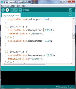

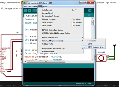

Step 3: Setup the Arduino Board With IDE
Once the connections are done connect, the arduino board through the usb cable. Arduino IDE must be installed on the PC to which the board wil be connected. Arduino IDE can be downloaded from the official website of Arduino, to know further information on how to download and which version to download click here. When connected for the first time, go to tools in Arduino IDE and check the port to select the com to which the board is connected. The code and the programming guide is given in the step 4. When ready with the code click on the "Upload" button in the IDE to upload it to the board. When the upload is complete the IDE gives an indication as "Done uploading".
Step 4: Programming

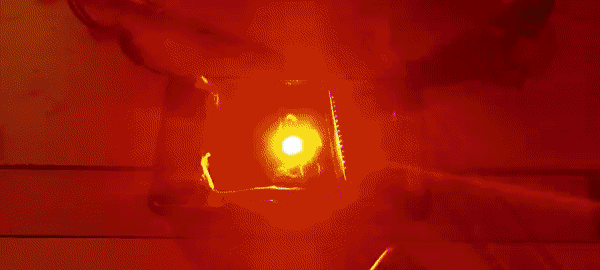

Step 5: Output
The video shows the detailed steps of the project visually and also its working. Each time when the button is pressed the LED changes it's mode.You can also make an outer box to the prototype and add an glass to dim the brightness of the LED. Hang it any where on the wall or use it in any lightning crafts.
