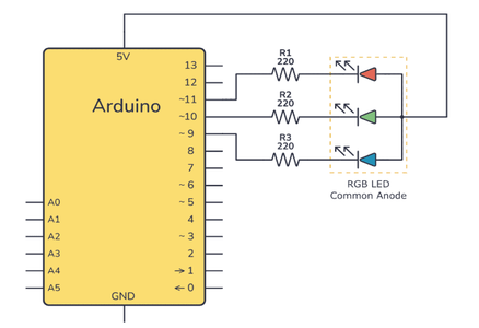

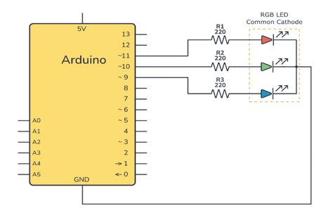

Here is the schematic for the circuit. This diagram uses three resistors and a common anode RGB LED (you'll find the schematic for common cathode below).
If you are using common anode LEDs, you will need to connect the common anode pin to 5V like this:

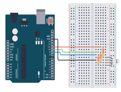

Step 2: Steps to Connect the Circuit on a Breadboard
If you are using a common cathode RGB LED, connect the cathode to the GND pin on the Arduino. If your RGB LED is common anode, connect the anode to the 5V pin on the Arduino.
Connect the red, green, and blue legs of the LED to pins 11, 10, and 9 of the Arduino respectively, each through a 220 ohm resistor.
Make sure your Arduino is connected to your computer via a USB cable.
Use one of the breadboard images below as a visual guide for setting up the connections.
Common cathode RGB LED connected to Arduino.

If you are using a common anode RGBLED, the logic is reversed compared to a common cathode RGBLED. In a common cathode RGBLED, you provide power (HIGH) to a specific pin to turn on a color. For a common anode RGBLED, you connect a specific pin to ground (LOW) to turn on a color.
So, with a common anode RGBLED, to set the color, you need to subtract each color value from the maximum value (i.e. 255) before applying it. This inversion ensures that a value of 255 (full intensity) for a specific color will cause that color to be turned off, while a value of 0 (no intensity) will cause that color to be fully turned on.
Step 4: Complete Arduino Code for RGBLED (Common Anode)
