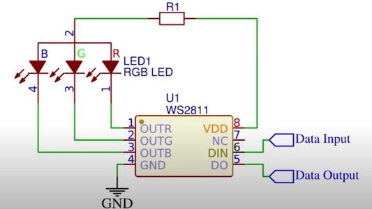

Step 1: What Are the Ws2811 LEDs?
- ws2811 is an RGB LED. Yet, it's anything but a basic RGB LED strip. It is an addressable RGB LED. It implies you can control each drove shading with an information signal info.
- You can get these information signals from various things like Arduino Board's Digital pin, from a legitimate RGB LED controller, and some more. The primary concern is that this information signal is a PWM beat. Thes PWM beats run the LEDs.
- The LED atrip which I am utilizing is ws2811 addressable RGB LED. The name ws2811 originates from the driver IC ws2811. For this, we consider this the ws2811 LEDs.
- In some cases, the IC might be inside the LED this sort of LED is known as ws2812 LEDs. These LEDs additionally work in a similar guideline.
- This ws2811 addressable RGB LED runs on DC 5V. So you should deal with voltage extremity.
The WS2811 RGB LED Controller which we are making today additionally takes a shot at DC 5V

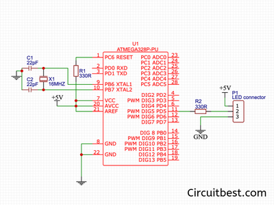

Step 3: PCB Process:
In this undertaking, we will require a controller and some other reciprocal parts for running the atmega328P chip. Coincidentally, in the event that you have a lower financial plan, at that point, you can utilize the atmega8 chip moreover. The atmega8 chip likewise has a similar correlative segment. Furthermore, you can likewise control the atmega8 chip with Arduino Uno utilizing Arduino as ISP.
For the PCB creation, I have picked the JLC PCB site. They are one of the biggest PCB makers in China. Simply Upload your Garber records today and get your initial 10 PCBs just for 2 dollars. They don't take additional charges for the PCB shading. Handling time is 48hrs and dispatching time is additionally snappy and you can see the PCB Quality in the video. Those are incredible. Furthermore, I have just paid 2 dollars.
