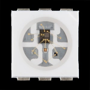

Addressable LEDs are a new generation of LEDs including a controller IC, in addition to RGB LEDs. This controller IC, usually WS2812, allows you to access multiple LEDs with a single digital pin by assigning an address to each LED and providing one wire communication. But unlike simple LEDs, these types of LEDs do not turn on only by applying voltage, they also require a microcontroller. NeoPixel is the Adafruit brand for addressable LEDs.

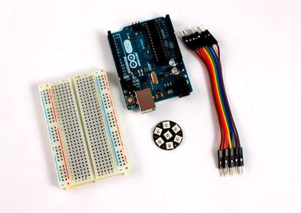

Step 3: Required Materials

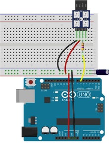

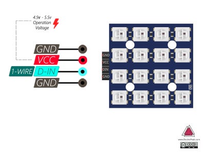

Step 4: NeoPixel and Arduino Interfacing
Note The resistor must be used to prevent the NeoPixel from damage and to transmit data correctly.
Note If you use a strip LED that contains a high number of LEDs, we recommend you to put a large capacitor (eg 1000uf) in parallel with + and – of the supply voltage.
Note The best distance to connect the first NeoPixel module is about 1 to 2 meters from the controller board.

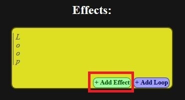

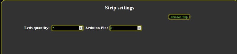

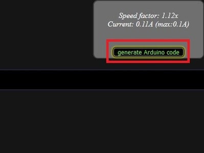

One of the most interesting tools on the web, to create effects on NeoPixels is the NeoPixel Effects Generator, which lets you specify the number of LEDs and Arduino pins, and after creating the effects and required settings, you can click on the generate Arduino code and copy the generated code to IDE. To do this, do the following steps:
- Click on Add Led Strip after entering the website.
- Click on the added NeoPixel Strip and specify the number of LEDs and Arduino pins.

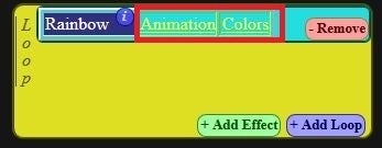

- Click on the Add Effect in the loop part and choose an effect.
- Apply your preferences in the Animation and Color sections.
- Click on generate Arduino code and copy the generated code to Arduino IDE.
