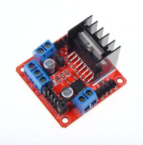

  3. LN298N DC Motor Driver

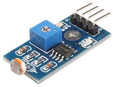

  4. Light sensor module

  1. Connect Power supply (batteries) pin (gnd) to motor driver controler pin (gnd)
  2. Connect Power supply (batteries) pin (+) to motor driver controler pin (+)
  3. Connect Power supply (batteries) pin (+) to Arduino pin (VIN)
  4. Connect GND from Arduino to motor driver controler pin (gnd)
  5. Connect digital pin(6) from Arduino to motor driver pin (IN1)
  6. Connect digital pin(8) from Arduino to motor driver pin (IN2)
  7. Connect Linear Actuator to the motor driver as you can see on the schematic
  8. Connect Light Sensor module pin [DO] to arduino digital pin [3]
  9. Connect Light Sensor module pin [VCC] to the Arduino pin [5V]
  10. Connect Light Sensor module pin [GND] to the Arduino pin [GND]

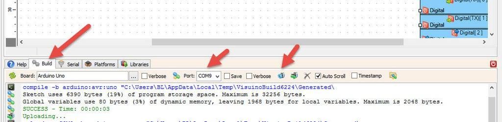

Step 3: Start Visuino, and Select the Arduino UNO Board Type
Start Visuino as shown in the first picture Click on the "Tools" button on the Arduino component (Picture 1) in Visuino When the dialog appears, select "Arduino UNO" as shown on Picture 2

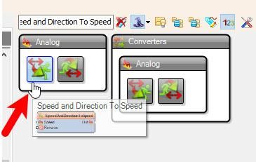

  1. Add "Speed and Direction To Speed" component

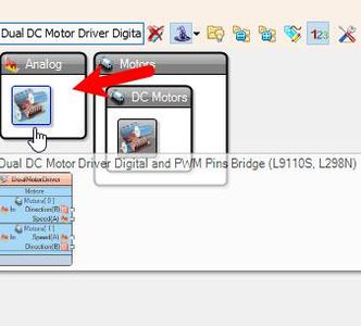

  2. Add "Dual DC Motor Driver Digital and PWM Pins Bridge (L9110S, L298N)" component

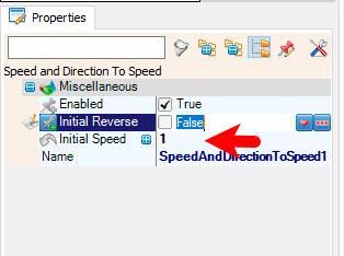

  3. Select "SpeedAndDirectionToSpeed1" and in the properties window set "Initial Speed" to 1 or any other speed value that you like

Step 5: Generate, Compile, and Upload the Arduino Code
In Visuino, at the bottom click on the "Build" Tab, make sure the correct port is selected, then click on the "Compile/Build and Upload" button.
