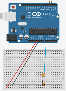

LDR to Arduino
- LDR lead 1 – Ground
- LDR lead 2 – 5V (via 10k resistor)
- LDR lead 2 – Analog Pin 0

This wiring is using a 2-channel relay module. This is a very simple setup that is easy to code, but it does have its limitations. If you want to add features such as speed control or force feedback, you may want to consider using the MegaMoto motor driver shield instead. More info on that here.
