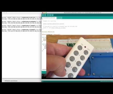

Step 3: Get Your IR Remote Control Codes
- Open Examples/IRremote/IRecvdump.ino
- Add IR receiver to your breadboard and run IRecvdump.ino project code in your board.
- Push remote buttons to show the code in your serial monitor
- My examples remote control codes are here: Arduino/TP2_IR_RGB_LED_strip/ir_remote_codes.txt
- Add your custom remote control codes in TP8_IR_Sender.ino
- Open your serial monitor
