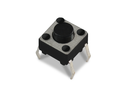

  • Connect Arduino Digital pin [2] to the Resistor and button
  • Connect other side of the resistor to the breadboard pin [GND]
  • Connect Other pin of the button to the breadboard positive pin [5V]

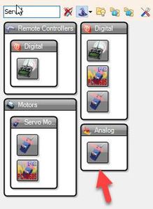

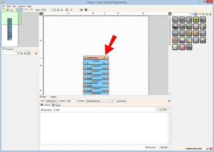

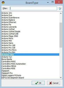

Step 4: Start Visuino, and Select the Arduino UNO Board Type
Start Visuino as shown in the first picture Click on the "Tools" button on the Arduino component (Picture 1) in Visuino When the dialog appears, select "Arduino UNO" as shown on Picture 2

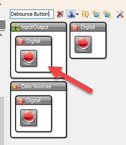

  • Add "Debounce Button" component

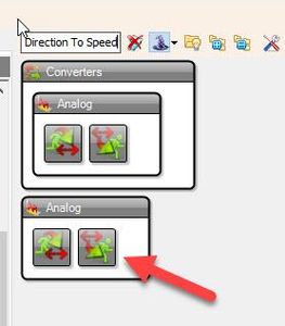

  • Add "Speed and Direction To Speed" component
  • Add "Servo" component

  • Connect Arduino digital pin [2] to "Button1" pin[In]
  • Connect "Button1" pin[Out] to "TFlipFlop1" pin [Clock]

  • Connect Arduino analog pin [0] to "SpeedAndDirectionToSpeed1" pin [Speed]

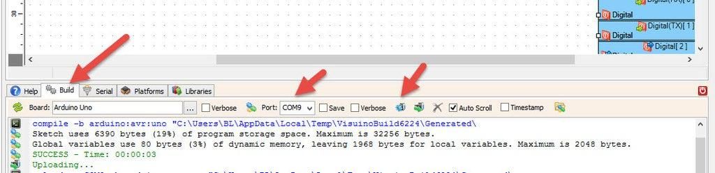

Step 7: Generate, Compile, and Upload the Arduino Code
In Visuino, at the bottom click on the "Build" Tab, make sure the correct port is selected, then click on the "Compile/Build and Upload" button.
