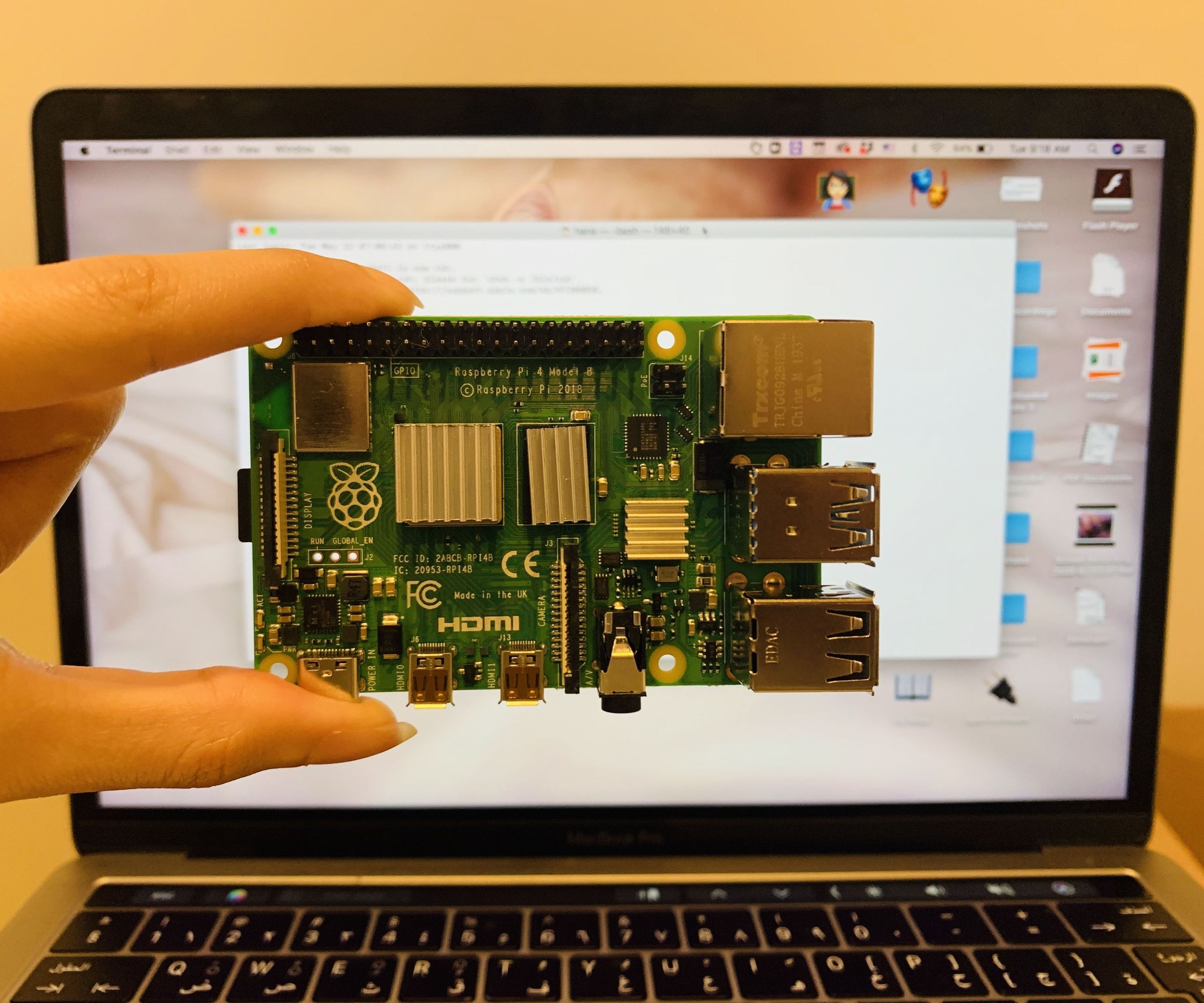

Raspberry Pi - I'm using model 4B

Third: Instal Plug your Micro SD to your Raspberry Pi Then Plug in your mouse and keyboard to the USB port
Step 2: Connect Your Raspberry Pi
Insert the Micro SD card underneath the Raspberry Pi on the left side
Connect your mouse and keyboard to the USB port
Connect your screen to the USB port and Micro USB port
Connect the power cable to USB-C port and plug it to a power supply
