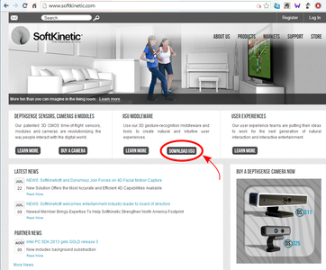

Go to www.softkinetic.com, click on the ‘Download iisu’ button on the homepage, download iisu Free (you will need to register first) and install it.

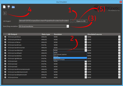

1. Load one of the scripts by clicking on the "..." icon.
3. Depending on the device, you can specify what you want to emulate.
6. Press "play" to start your emulation
The scripts are where iisu computes the values that can be linked to our controls.
- If you have a close range camera use DeviceEmulator\CloseRange\CI_Example_Script_With_Gestures.iid or any file from the CloseRange folder
- • If you have a long range camera, use DeviceEmulator\FullBody\GestureLibrary_Hands_Manipulation.iid... or any file from the FullBody folder
Once the script is loaded, you will see the values that are computed in the script. You can map them to the devices you want to emulate.
2. Choose the device(s) you want to emulate by clicking on "none" in the "Emulator" column.3. Depending on the device, you can specify what you want to emulate.
- For a keyboard, choose which key will be mapped to your value. Keyboard emulation only works with Digital Values (on/off).
- For a joystick or a mouse:
- With Digital Values (On/Off), choose which button you want to map
- With an Analog Value (continuous value), choose which axis you want to emulate
- For Arduino, you have to choose the Pin and Pin Type. More details on how to use the Device Emulator with an Arduino on the next step.
This is useful when you emulate your mouse and you want to control it back as soon as no one’s body or hand is detected. You might struggle to control your computer with anything else than gestures.
5. Optional step: press "Open in IID" if you want to edit the script and generate new values6. Press "play" to start your emulation

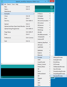

1. Upload the "StandardFrimata" sketch to your Arduino.You can find it in the Arduino IDE in File>Examples>Firmata>StandardFirmata
