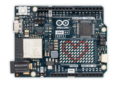

Step 1: Understanding How Arduino Connects to WiFi (with UNO R4 WiFi)
Before diving into the code, it's important to understand how the Arduino UNO R4 WiFi fits into your local network environment. The diagram below illustrates the topology we'll be working with.
📡 Network Architecture Overview:
Your Arduino UNO R4 WiFi connects to your home WiFi router, just like your smartphone and laptop. This puts all the devices on the same local subnet — in this case, 192.168.68.0/24.

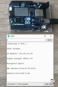

Step 2: Display WiFi Connection Info in Serial Monitor
In this step, we connect your Arduino UNO R4 WiFi to your wireless network and display critical connection information using the Serial Monitor.
🔧 What This Code Does:
  1. Connects to your WiFi network using SSID and password
  2. Waits until the connection is successful
  3. Prints network info: SSID, IP address, signal strength (RSSI), encryption type
  4. Shows MAC addresses for both the Arduino and your router

🧪 Testing:
  1. Upload the sketch to your Arduino UNO R4 WiFi.
  2. Open the Serial Monitor at 9600 baud.
  3. Watch for the WiFi connection progress and detailed network info.

  3. Open the Serial Monitor to note the IP address.
