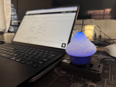

  1. Assemble an enclosure for the Pi: 3D print (or buy) an enclosure for your Raspberry Pi. I found an existing design that I liked to fit a Raspberry Pi 4 Model B that provides access to the GPIO pins. You can additionally modify an existing design to include a built-in mount for your LED.
  2. Assemble an LED display: 3D print (or buy) a display for your RGB LED. I found these mushrooms that I liked originally designed for wireless LEDs, but could contain the LED and wires, and also function as a lamp shade to illuminate more surface area. RGB LED enclosure with wires coiled insideStuffed Mushroom: In this example, I used solder, heat shrink tubing, and electrical tape to bundle everything together. I then used a soldering iron to create a hole for the jumper wires to exit from the bottom. If you prefer the mushroom to sit flush against a surface, you can route the wires out from the back instead. You can also use a small development board or get creative with your breadboard!
  3. RGB LED wires at the bottom of the mushroom
  4. Position the LED: The LED can be placed as near or far to the Raspberry Pi as your jumper wires allow. Mushroom on top of Raspberry Pi
