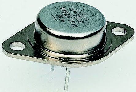

Step 4: Voltage Regulator
I'm gonna be using a LM7805 voltage regulator (5v). By the way last two digits actually tell the voltage. The fist picture tells wheres the GND, input and output. I also uploaded a datasheet of that voltage regulator where you can get more information about the voltage regulator. If you don't know much about these then you should google about it. After all google is your best friend when you are working with circuits. Now, make the circuit like i showed you in the 2nd picture. And now you are done.

Now, I'll tell you why I used 12v instead of 5v output rated transformer. The voltage regulator will constantly supply 5v provided that the input is above 5v. Your transformer's output also depends on it's input. If the input is above 220v the output must be more than 12v and if the input is lower than 220v the output must be lower than 12v. Same thing could happen I had used a 5v output rated transformer. In some cases it wouldn't able to provide 5v. Some times it can be less than that. Long story short, a voltage regulator stabilizes voltage. And if your transformer's output is 5v, it may not always provide 5v. If the transformer's output is 4v then the voltage regulator will give you 4v. And if it is 9v or 10v or 12v then the voltage regulator will always provide 5v stable output. It can't be more than that, provided you are using a 5v voltage regulator.
