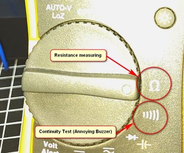

Now using your voltmeter, check continuity between; (using the buzzer selection.)
Pin 16 and Ground,
Pin 15 and Ground,
Pin 14 and Ground.

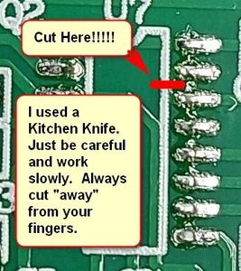

Now using the desoldering gun I started blowing air from top to the Chip legs from an angle so I did not remove anything else. From the image you can see the shaded area where you should concentrate. I used a small screw driver to lift the Chip as the solder softened and melted. make sure to keep the gun moving and not concentrate hot air to one area. Make sure to use a 3rd hand to hold the board and not wiith your hands...
Once removed you can see the traces and where to cut.
The trace is under the white line so we will cut between 14 and 15.
Step 4: Making the Cut
Now that we know the location, get your trusty sharp knife out (I used a kitchen knife with a sharp edge) and start scraping the trace.
Always pull the blade away from yourself.
Do not rush.
Do not use force. let the blade do the job. you will pass through the white and green paints then you will see the shiny copper trace. keep at it until you see the fiber board. you can see my final result that worked.

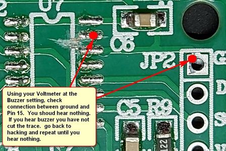

No measure the connections between:
Pin 16 and Ground, (No buzzing)
Pin 15 and Ground, (No buzzing)
Pin 14 and Ground. (Buzzing)
Once you hear no buzzing between Pin 15 and Ground, you are done. (well kind of...)

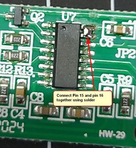

Step 6: Making the Last Connection.
Now connect Pin 15 and Pin 16 using a small blob of solder.
Now check Continuity again. This time Pin 15 and pin 16 to ground (no buzzing)
Pin 15 and 16 to Vcc (Buzzing)
