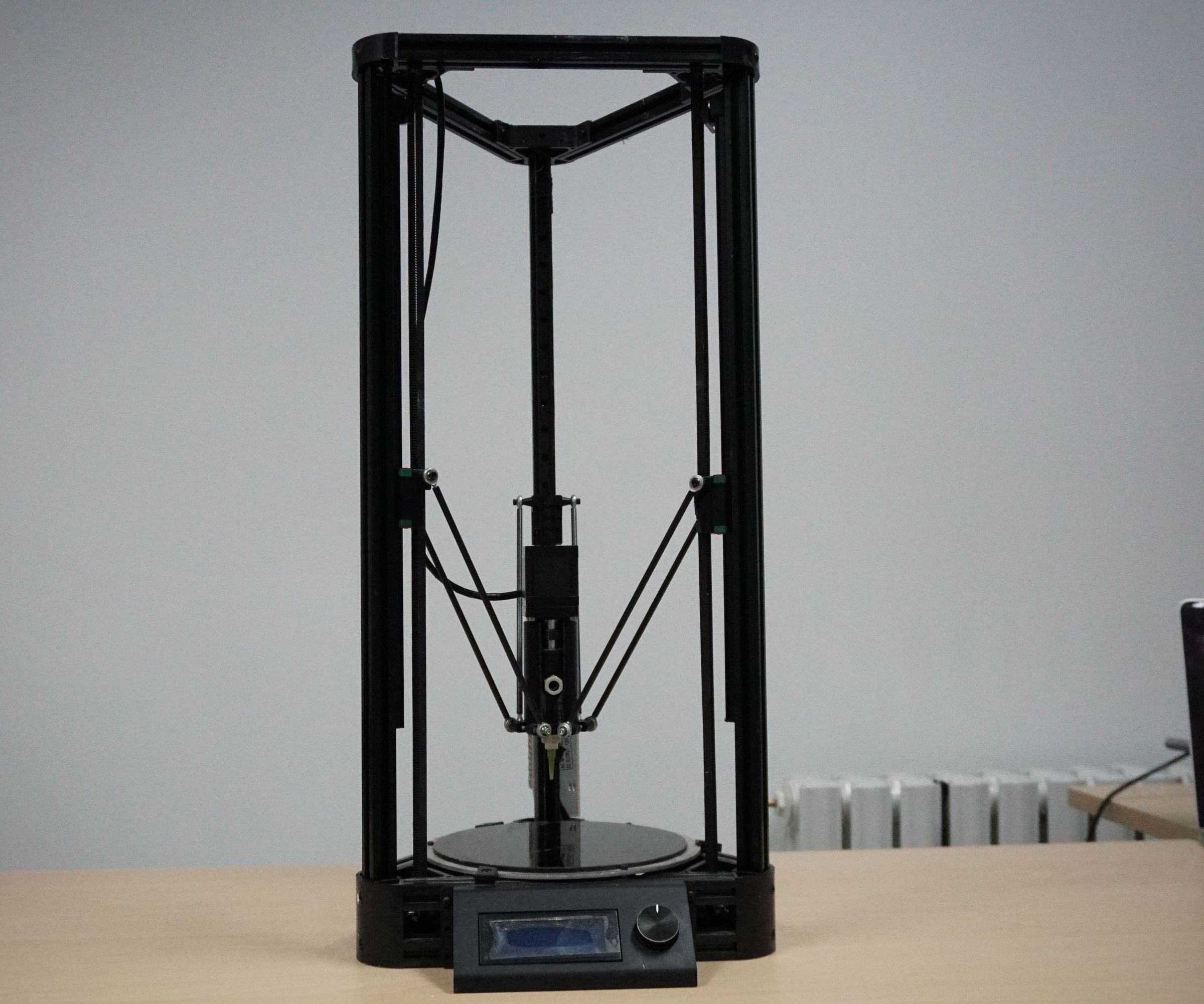

Step 1: Download Accessories
The following tutorial uses a Mooz printer as an example.
1. First you need to download the modified accessories of the CERARBOT extruder kit from here and print it with the printer.
Step 2: Mounting Accessories and Extruder Kit
2. Remove the printer's nozzle, install the modified accessory, and install the CERAMBOT extruder on the printer.
Step 3: Installation Circuit
3. Remove the driver board from the printer head and plug the signal cable of the CERAMBOT extruder into the drive board of the FDM 3D printer.
Step 4: Upload Firmware.
4. Re-copy the changed FDM 3D printer firmware.
Step 5: Start Ceramic 3D Printing
5. Start ceramic 3D printing
