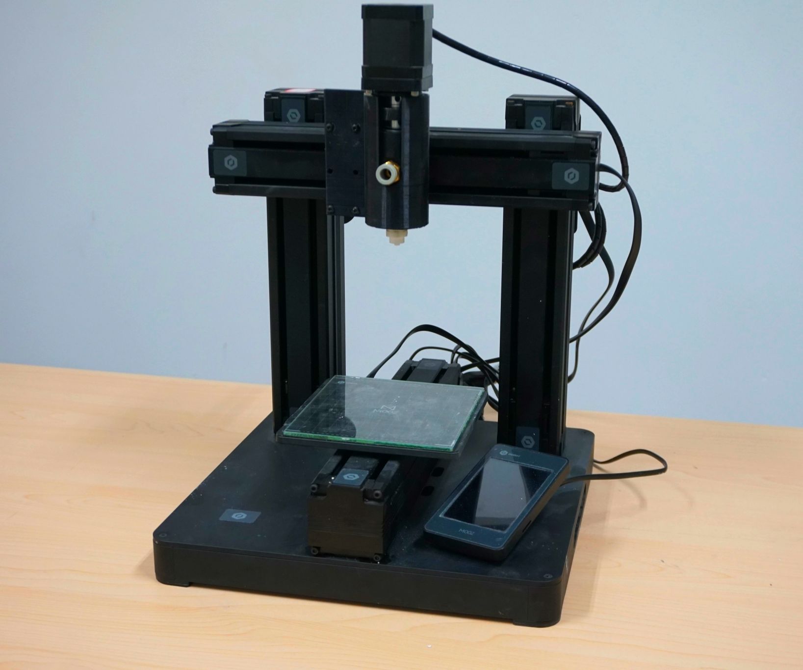

1. First you need to download the modified accessories of the CERARBOT extruder kit from here and print it with the printer.
Step 2: Mounting Accessories and Extruder Kit
2. Remove the printer's nozzle, install the modified accessory, and install the CERAMBOT extruder on the printer.
