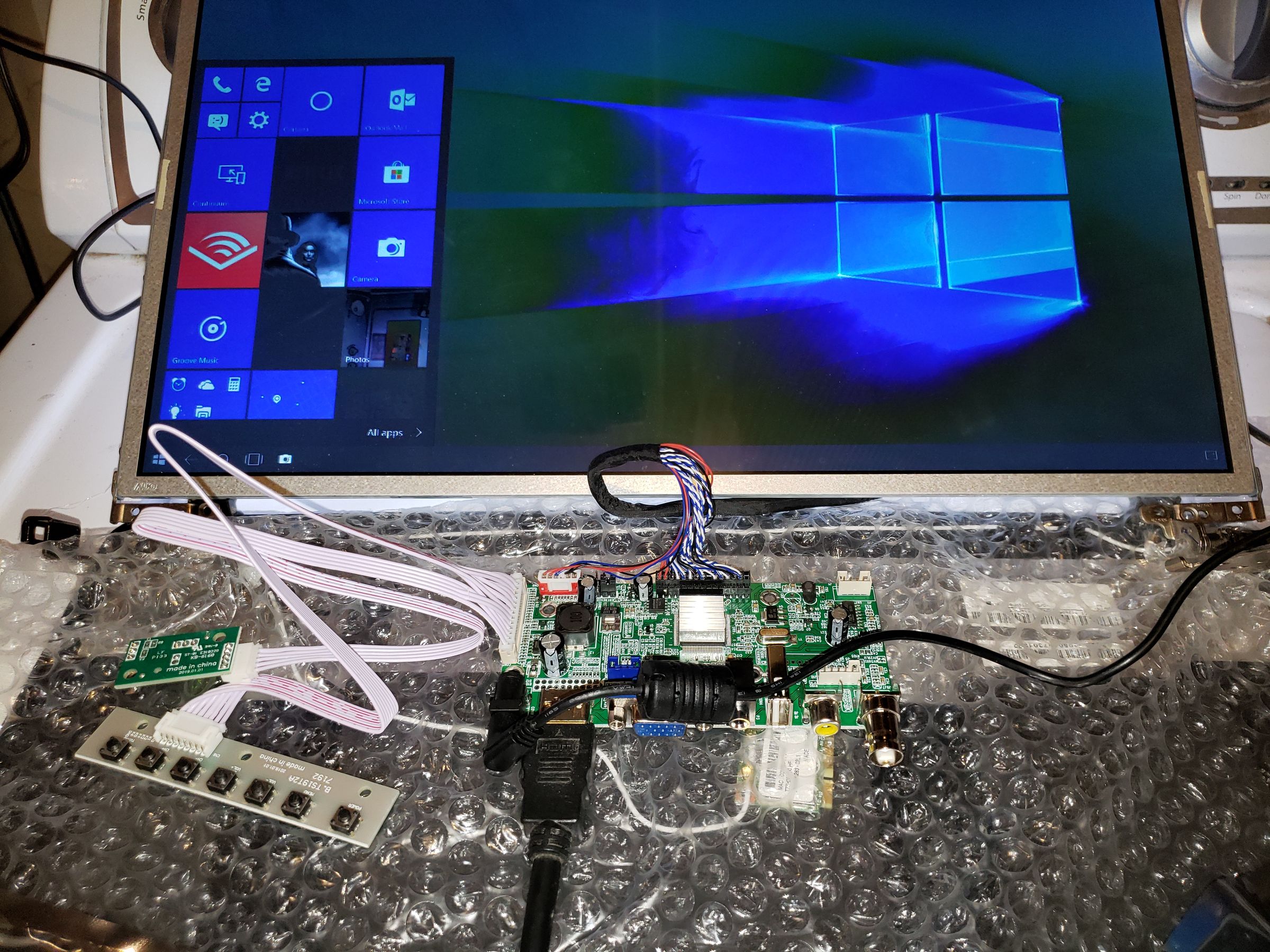

Step 6: The Cables
Here is a picture of the LVDS cable and the inverter detached from the LCD screen. Since we will be buying an LCD control board these cables will not be needed again.
Step 7: Buying the LCD Controller Board
Next, once you have removed the LCD panel. Flip it over and look for a model number on the back. You will need this model number to order the correct LCD controller board. I went to E-Bay and found one for $42.00. I bought the LCD controller board and then received an email from the seller requesting the model number of the LCD screen and manufacturer. This is because each controller board is flashed, (programed to run a specific LCD) I gave him my model number, LP171WX2 A4K1 and told him it was made by LG Phillips. Since the board was coming from China, I received my order about 2 weeks later. Due note to buy one with a power cord! The LCD controller board has the VGA input connection which allows you to connect it to another computer and use it as a second monitor or as a back up in the event the one on your working computer goes out.
I bought my LCD controller board DIY kit from e-qstore on Ebay. Here is a link:
http://www.ebay.com/sch/m.html?_from=&_nkw=&_armrs=1&_ssn=e-qstore&rt=nc.
Mention Instructables they might give you a discount.
The LCD controller board is real easy to connect. It comes with all the required cables, except a VGA cable which you will need, in order to connect your LCD to another computer. You can buy a VGA cable from Best Buy or a computer parts store.
Step 8: The LCD Control Board
The LCD control Bard comes with all the cables except the VGA cable which you will have to buy. Once you have received your kit, proceed to connect it to the LCD screen. Plug the LVDS cable into the LCD panel where you removed the original from. The two wires at the bottom of the LCD screen that were connected to the inverter need to be unplugged from the old inverter and plugged into the new inverter below. Then, plug the power in. Make sure that the LCD control board is not sitting on anything conductive, like metal or it will short and fry. Next connect the VGA cable to the LCD control board and plug the other end of the VGA cable to another computer. Make sure the computer is on before you plug in the VGA cable. At this point you should have the same image that is on the computer you plugged the VGA cable into, on the LCD panel.
To recap:
1. Plug the LVDS cable into the LCD panel.
2. Plug the LCD panel into the inverter. See picture.
3. Plug the transformer into the LCD control board.
4. Connect the VGA cable to the LCD control Board.
5. Connect the other end of the VGA cable to an operating computer.
6. Press the power button on the LCD control Board-it sits next to the LED.

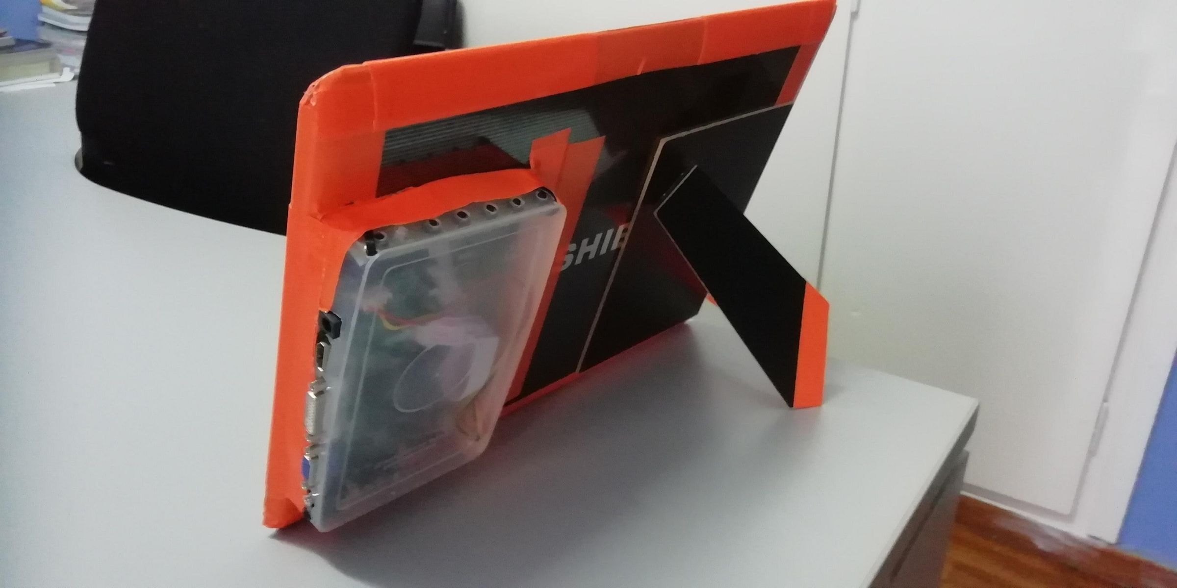

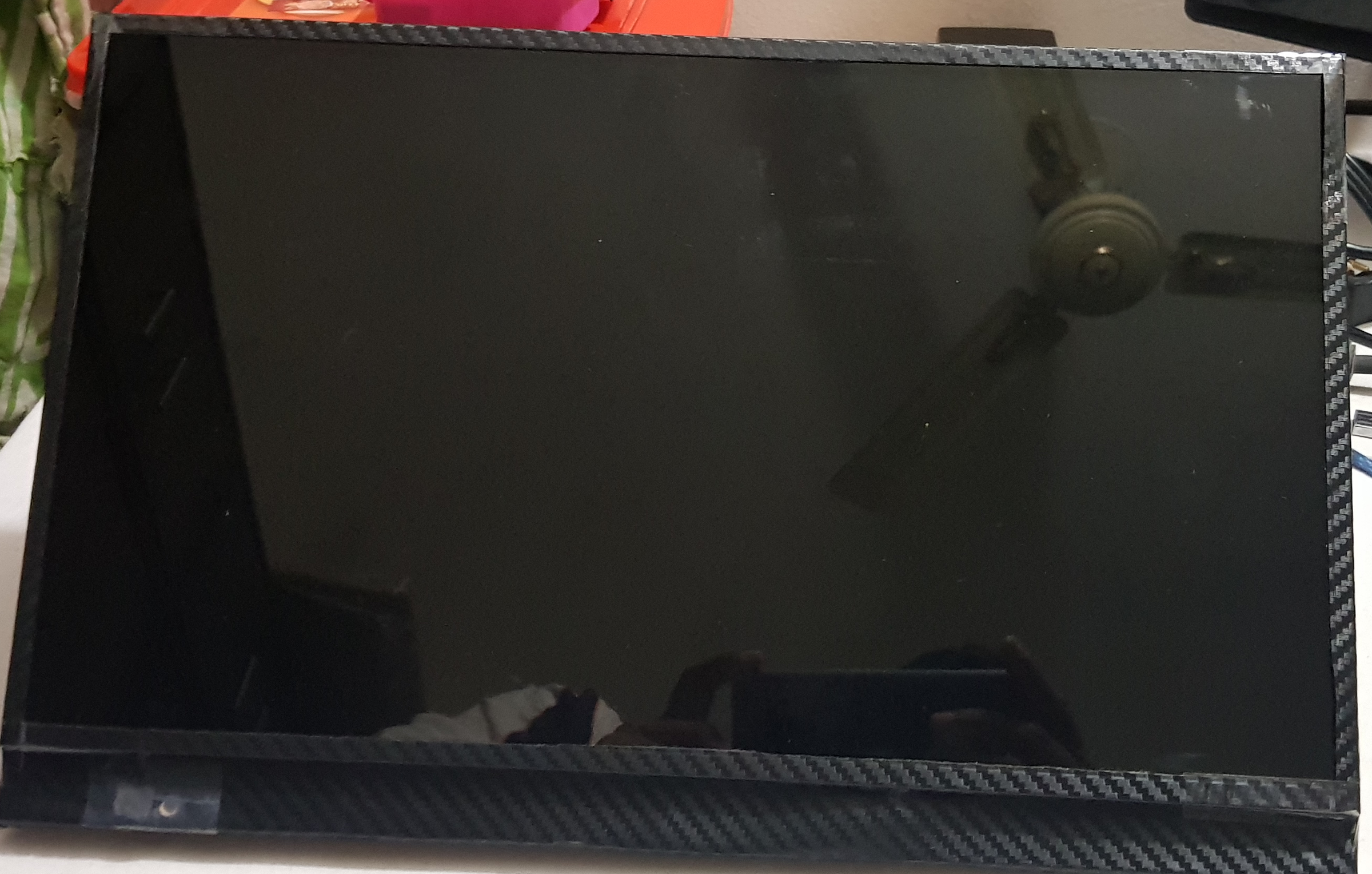

Thanks for this instructable. I recently came upon some discarded laptops with either had bad screens or nonfunctioning everything else. I may be able to mix and match to get a usable machine out of the pile of junk!

I checked ebay for the LCD control Board and all I did was punch in " LCD control Board for a LP154W01(A3)" , That's my model number. You, of course, use your's. ebay came up with the correct one for $25.00 and it has all the imputs you could want. This is good today, 2/11/19. Have fun folks!
