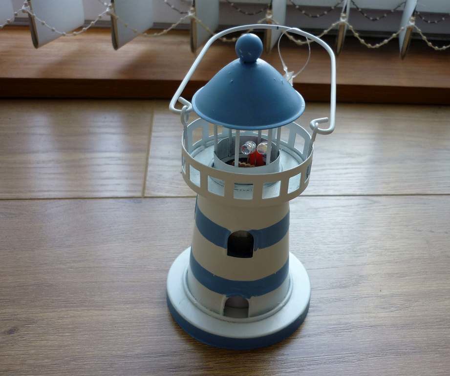

For a child's nightlight something more junior friendly might be appropriate and there is an example in the picture above of something that would convert. This one was bought a couple of years ago when they were being sold off and do not seem to be available now although you may find them on market stalls, however perusal of a current catalogue shows a 'Solar Stone Owl Light' with two LED eyes and this would make something that a child would truly treasure. They would convert in the same way as shown in the article. There is a vast amount of this sort of material available and it is a constantly changing market.
