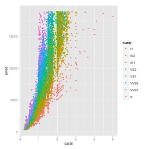

1. Group the scatter plot of price vs. carat by clarity using the option 'colour.'
qplot(carat, price, data=diamonds, colour=clarity)<br>
Note: The ggplot2 option 'colour' is intentionally spelled in British English form because the creator, Hadley Wickham, is from New Zealand.
