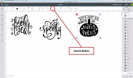

Step 1: Source Your Designs and Customize
I bought these SVG files from designbundles.net.
Figure out what size suits you and customize the size (for each design) by first clicking on the 'Unlock' button and then entering the dimensions you need. 4 by 4 works well for me.

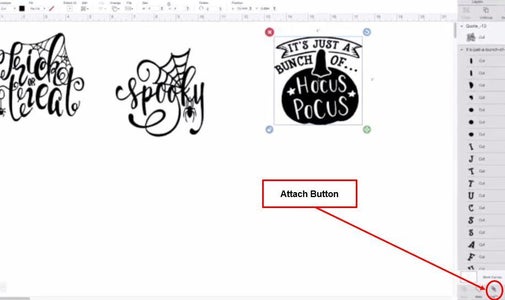

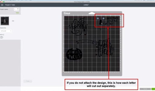

Step 2: 'Attach' All Parts of Each Design
It is extremely important to 'attach' all parts of a design. Otherwise, everything will cut out separately and you will go crazy trying to put everything together. Select a design and click on the 'Attach' button on the bottom right of the screen. Do this for each design.
Then hit the 'Make It' button on the top right corner.

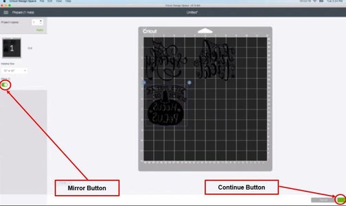

Step 3: Align the Designs on the Mat and Mirror Them
Move the designs around a little so that you have some space between them. This will make it easier for you to cut them out.
Next click on the 'Mirror' button. This is especially important since we will be using the heat transfer method.
Then click on the 'Continue' button on the bottom right of the screen.

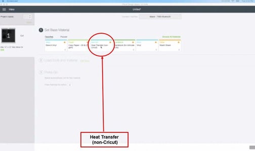

Step 4: Select the Material Settings and Print the Designs
This is what my screen shows after I click on the 'Continue' button. I use the Cricut Maker; so your screen will be the same if you use it too. In any case, select the settings according to what you are using.
I chose 'Heat Transfer (non-Cricut)'. This is because I am not particularly sticky about Cricut HTV (heat transfer vinyl). I buy whichever HTV brand is on sale. So, this time around, I am using non-Cricut HTV.
