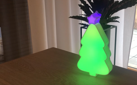

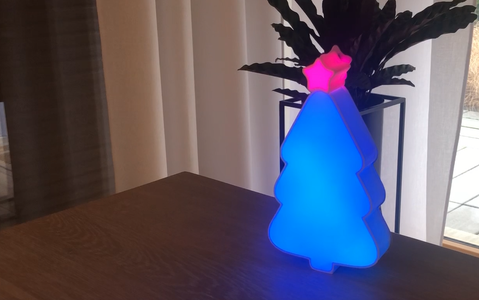

Step 7: Final Result
The leds light up as expected.
When I put the front panel in place the effect is great.
You have to watch the video linked at the top this instructable.
Standard code however is "too loud" for me.
In the video you will find the breakout of code, I wrote, that provide much smother color transitions with glistening effect. Also the star at thetop of the tree changes color but is always in stark contrast to the rest of the tree.
