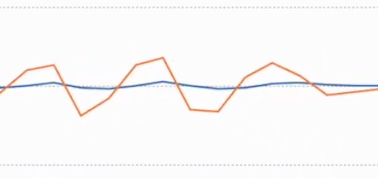

Step 2: The Outcome
After running this on my acceleration data I get a graph resembling the following
Where the spikier signal is the raw signal and the smoother signal is after it is passed to the low pass filter. See more details of this in my Youtube Video above.
