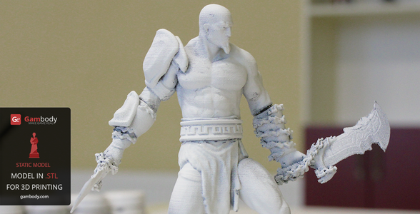

The slicer converts the file in the G-code, your 3D printer’s language. Once the G-code is generated, save it on an external drive and insert it into the card slot of your 3D printer device.
Kratos 3D model is printed in grey PLA material. It printed clean, without visible layer patterns. Therefore, we used no sanding to smooth the surface of the model, as the surface is already smooth enough. Support removal was easy.

The coating with white primer ensures coverage of the PLA material’s colour and acrylic paint adhesion to the model.
Then you use your imagination and paint your model applying any colours you like. We painted the model in his video game colours, to make it more realistic. Pay attention to details. Don’t forget to paint the scars, battle wounds and blood traces, witnessing the model's engagement in battles.
Step 7: Step 7: Final Result
The picture illustrates from what we started and what we came to in the end. A digital file has been created into a beautiful physical model.
