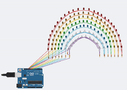

Take all the red LEDs. Arrange them in an arch shape to resemble a rainbow as you put the circuit together. We have to connect each LED's longer leg (anode) to the Arduino board's digital pins using a separate resistor. To avoid the mess, instead of connecting every LED to the digital pin, we can connect all the same-colored LEDs in series. Now we only need to connect one end of the wire to the particular digital pin. The ground (GND) pin on the Arduino board is where you connect the cathodes of all LEDs in a similar way.
Step 2: Add Orange,Yellow,Green,Blue LEDs
In a similar way, add Orange, Yellow, Green, and Blue LEDs in series and connect them to ground and their respective digital pins. Make sure the digital pins you select are next to each other so that we can later use a for loop to easily control each color

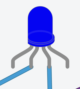

For Indigo, We will connect the Blue pin to the anode. Experiment with the values of Resistance to get a color similar to Indigo.

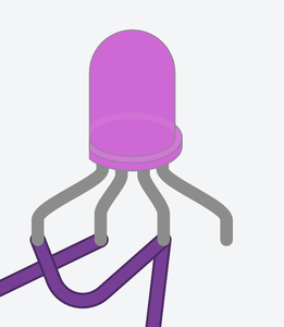

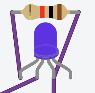

Now for Violet, We will use blue with a little help from red to get the required color. For this, we can connect the Blue and Red pins. But we get a pink color. This is because the red color is more than what's needed. To reduce the amount of red, we can add resistance in between. Again, experiment with values of resistance to get the required color.
