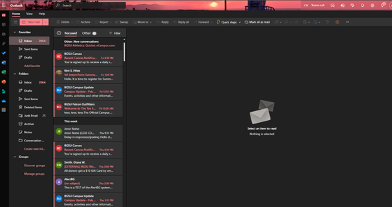

Step 1: Getting Started
Open the latest version of outlook downloaded on your computer. In this example we will be using Outlook365 available online. Be advised as the interface itself looks a bit different on Outlook365, but behaves the exact same as Outlook.

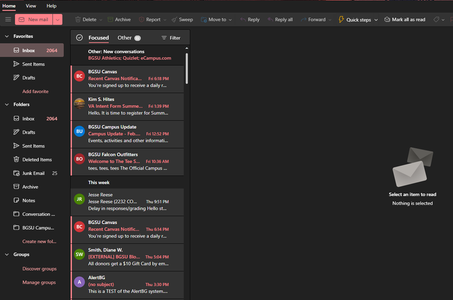

Step 2: Create a Folder
Create a new folder where you want the bulk emails to populate in. I would recommend naming it something where you will know exactly what is located in it at a glance.

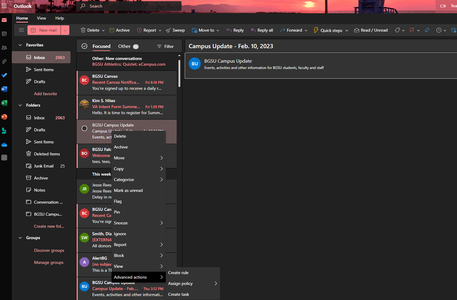

Step 3: Choose an Email
Right click an email from your inbox in which you want to send every email from the sender to the new folder. You will right click then go to advanced options then create rule.
Step 4: Select Your Folder
From here you will be prompted to select a folder. Select the folder you created and press OK.

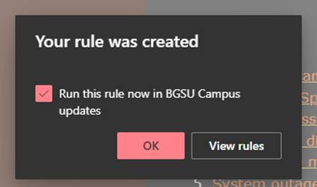

Step 5: Rule the World
You will be prompted that your rule was created. In order to start running the rule and get all the previously sent emails to go to the new folder, you must check the box that says “Run this rule now in inbox.” Press OK and Outlook will begin to run your new rule.
