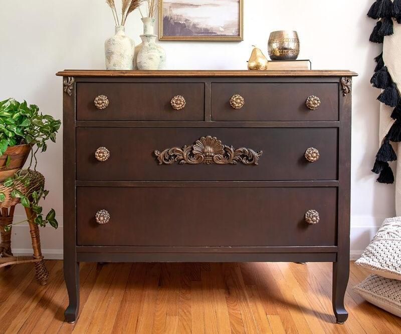

Step 1: Prep & Clean
I started with this set of carved wall art that I bought from our local thrift store. Whenever you are painting a piece, it is important to clean it to ensure paint adhesion. And since this wall arts are already clean, I started preparing my paint.
Step 2: Paint Light Base Coat
I painted the pieces with two coats of medium-toned tan chalk mineral paint. It is the perfect base coat for the finish that I am looking for which has a light and warm tone. If you want to have a darker wood finish, you can experiment with a piece of plywood or any cardboard before doing it on your project.
Step 3: Paint the Darker Shade Paint
When the base coat was completely dry, I painted the wall art with creamy brown chalk mineral paint that looks like Chocolate.
Step 4: Paint Wash
This is the part where we transform the paint to look like wood. After painting the pieces brown and while it is still wet, I sprayed them with water using a water mister bottle and wipe them off using a shop towel to create a wash. Repeat the depending on how light or dark you want the finish to look.
Step 5: Adding Texture
I used a chip brush and lightly rubbed the brown paint using the tips of the bristles. I next used a shop towel to remove any leftover paint from the paintbrush tips. I lightly dry-brushed the high spots while moving in a single direction. This creates a little more texture and authenticity to this piece.
Step 6: Finished Look!
And here is the finished look! They look so much better than the all-black plastic look. You can any this technique to any piece that you like as long as it can be painted! I hope it inspired you to try!
