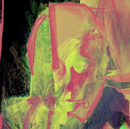

Step 4: Displace the Vertices of the Mesh by the Contents of the Image
Press "G" to bring up a small control panel. This is where we enable displacement of the vertices. Click on the "Enable Displace" button. You'll see some around starting to expand then contract. Congratulations, you've not created a 3D mesh based on the contents of the image.
But what exactly is happening? At each vertex, the application looks at which pixel of the image is on top of it. The brighter the pixel, the more the displacement. So we're driving 3D mesh creation by the brightness of the pixels. The actual part of the software that does this is quite short. Here it is commented to see exactly what's going on.
Step 5: Explore Some More
Here is a video file showing my explorations of this image. I'm altering the other two sliders, which controls how fast the mesh displaces and how much it displaces.
