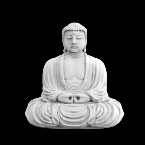

The starting point of this project was a printable 3D model freely available on our website: The Great Buddha at Kamakura, Japan.

Look for an appealing Scan The World model. It would be prefereable to choose a cultural artifact which does not need many supports while printing. Also, it is useful to print an object which can easily stand on a flat base as it will help realize a more stable lamp.
In this case we selected this model "The Buddha from Kamakura".

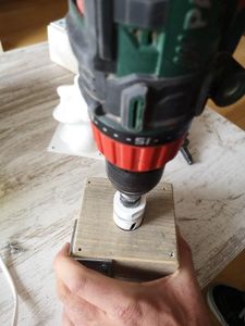

Take the wooden box which will act as a base, realize a hole on its top with the help of a drill. Another hole on the side of the box will be the exit space of the light cable.

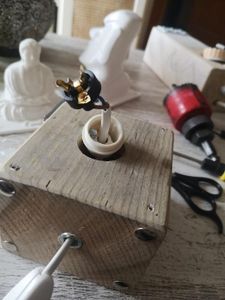

Step 10: Placing the Lightbulb
To finish the lamp, take the cable and lightbulb with incorporated light switch and pass it through the holes realized with the drill.
