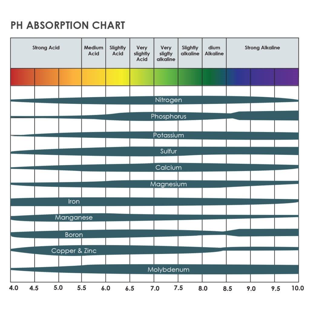

Acidity is fundamental for life on earth. It determines the properties, quality, absorption and solubility of many substances. The pH value indicates the acidity or alkalinity of a solution. The pH scale ranges from 0 to 14. A solution with a pH between 0 and 7 is acidic and a solution between 7 and 14 is alkaline.
Optimal pH is usually between low 5's and low 6's
The simplest method of correcting the acidity is to reduce the pH of the nutrient solution with sulfuric acid or to increase it with sodium hydroxide.

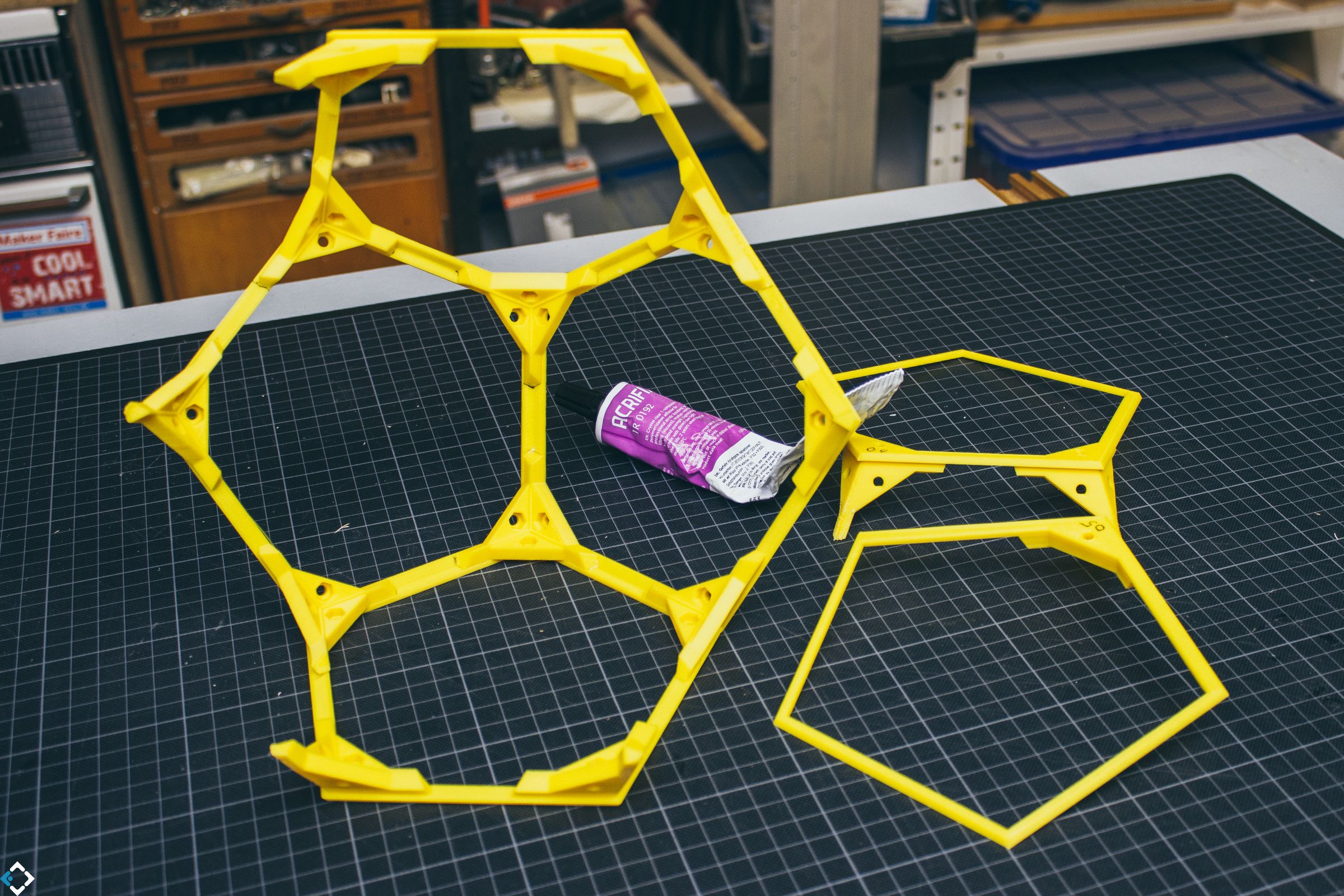

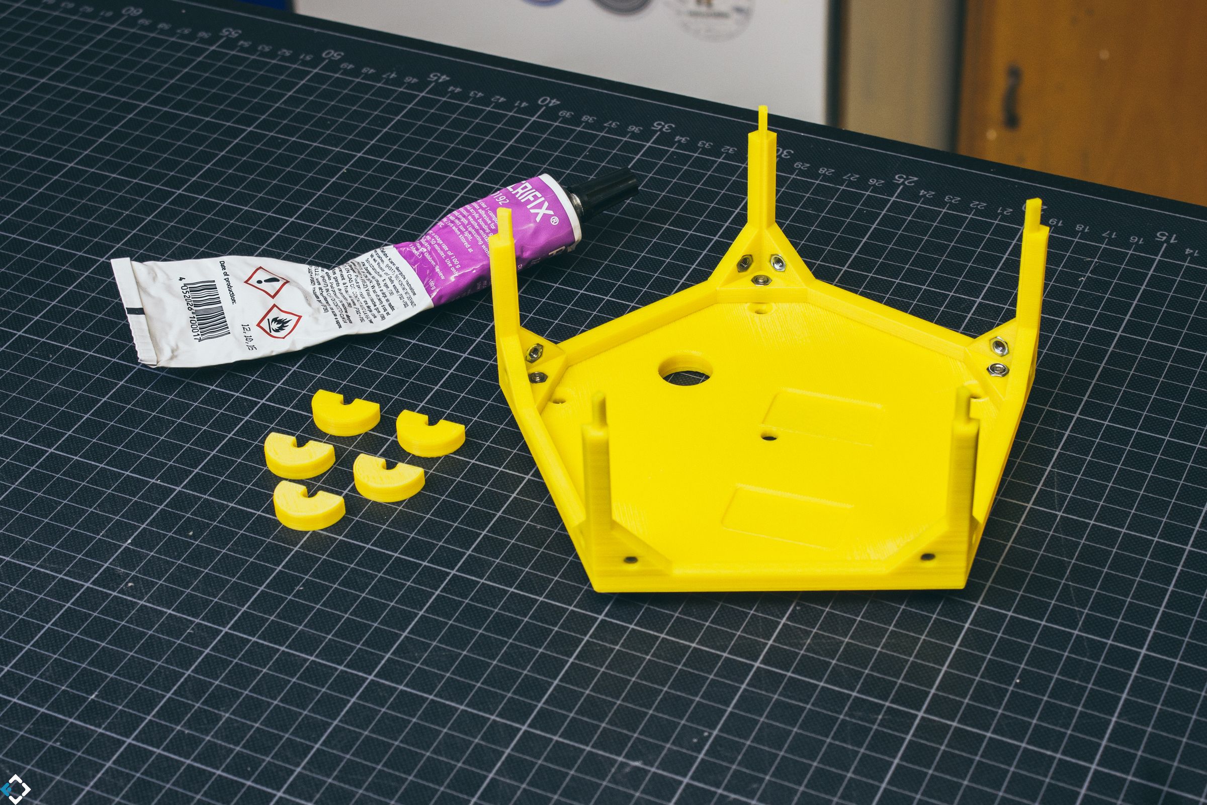

Adhesives/solvents
In some places, it is necessary to glue or fuse components together. I use very good but harmful adhesives/solvents, which damage the respiratory tract, cause acid burns, but can also be carcinogenic. A suitable respiratory and eye protection, as well as gloves and good ventilation, are therefore absolutely necessary.
https://www.acrifix.com/sites/lists/pm/documentsap...
https://en.wikipedia.org/wiki/Dichloromethane
https://www.dosieren.de/media/pdf/da/5f/98/UHU_SOF...

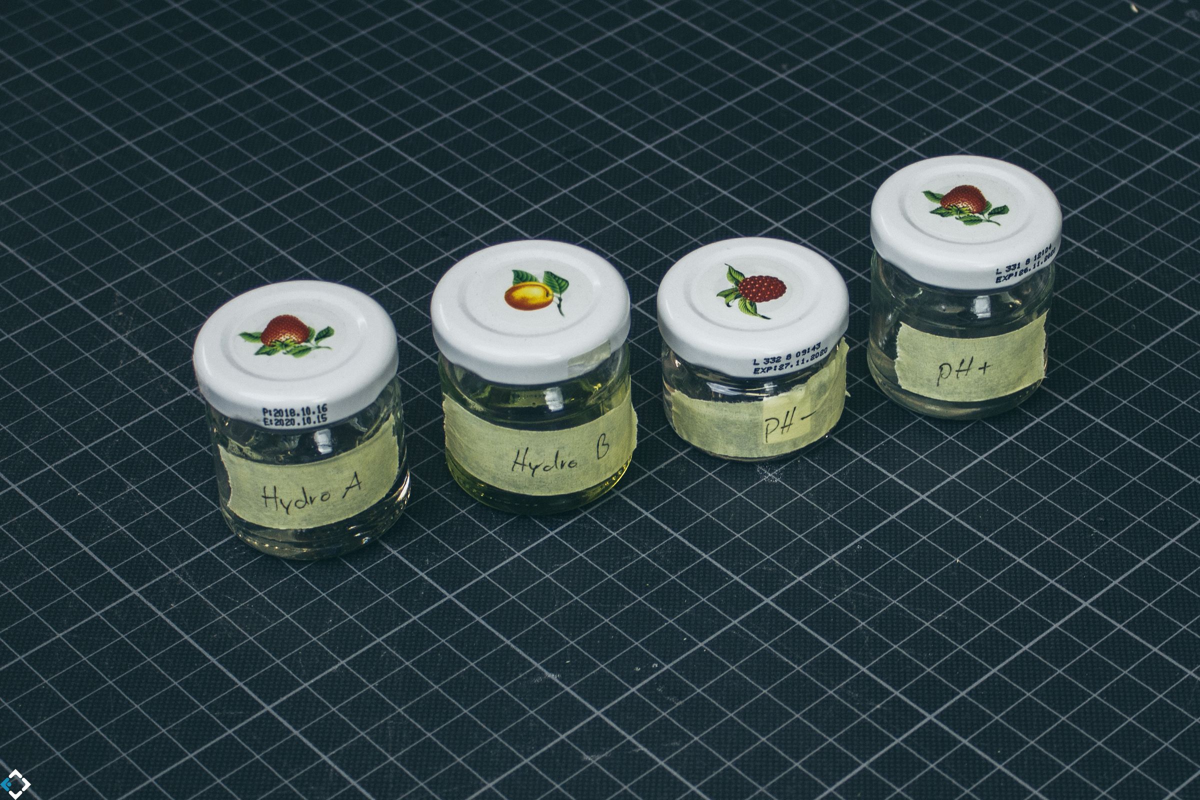

Fertilizer/pH-regulation
Only with water, the plants will not be happy for long. Plants need nutrients (Fundamentals). For this reason, certain additives are necessary. In concentrated form, these substances can lead to acid burns.
https://en.wikipedia.org/wiki/Sodium_hydroxide
https://en.wikipedia.org/wiki/Sulfuric_acid

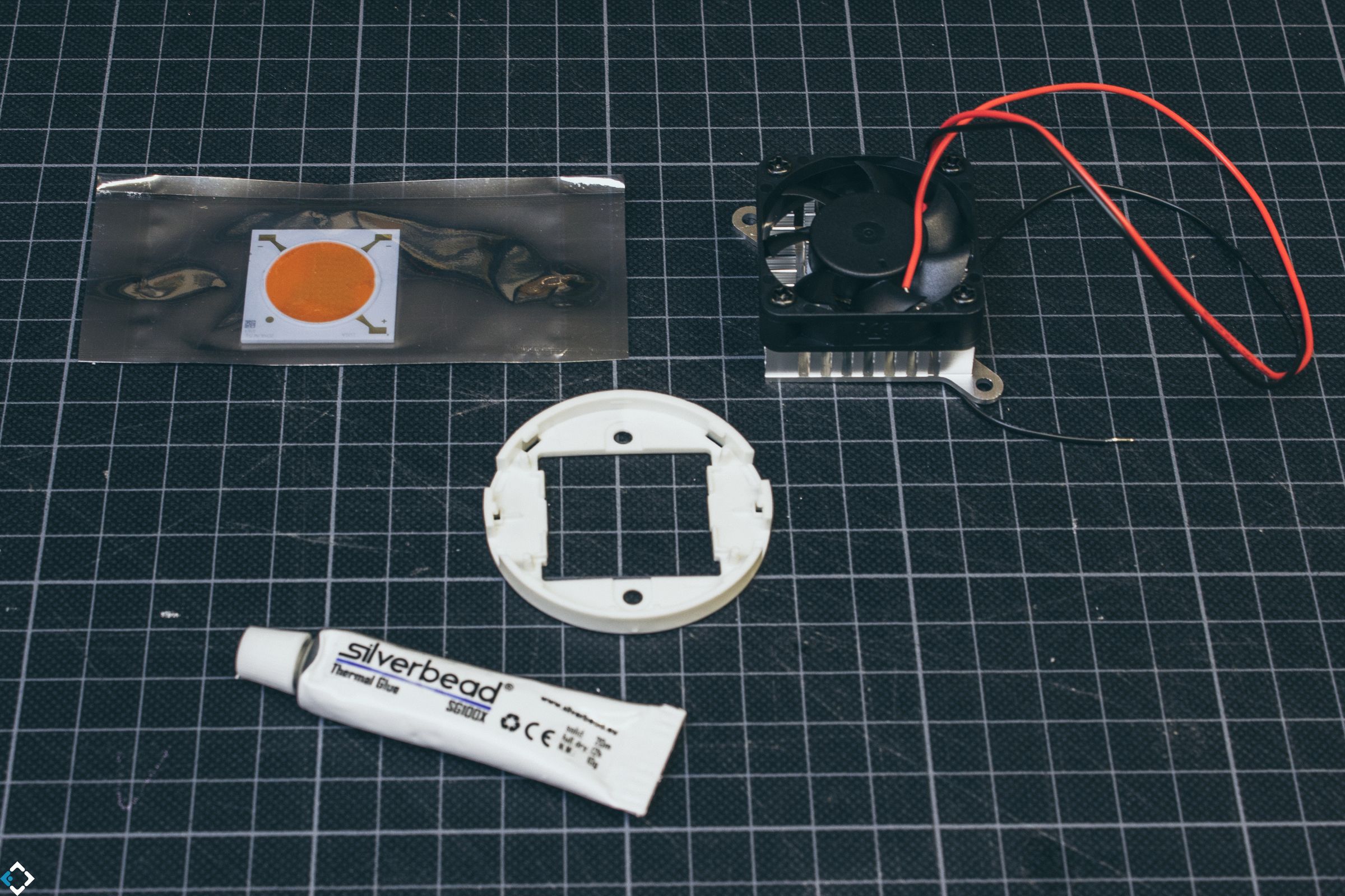

Plants need light (Fundamentals). For this, I use high-power LEDs, which can get very hot very quickly. Touching them can lead to burns.

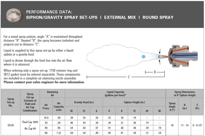

But how does such a nebulization work? I found 3 variations:
- Single-fluid nozzle
- Two-fluid nozzles
- Mechanical
https://en.wikipedia.org/wiki/Spray_nozzle
Without having dealt with it, 2 variants have been removed from the shortlist.
Do not transport air, an additional supply is required
Too much water is transported - Mechanical
Droplet size too small
Fog spreads on the ground, must be transported with the help of a fan.
This leaves only the Two-fluid nozzles. There are several ways to build it up:
- Low pressure
- High pressure
- Internal-mix
- External-mix
The high-pressure variant also died quickly. Available nozzles would spray too much water, which would be more like a flood in HOPE. Furthermore, the resulting spray jet would simply disassemble the system. Because with up to 2,6m (!) this is way too much. Due to its size, an HP compressor will not fit into the system.
This leaves only low pressure.

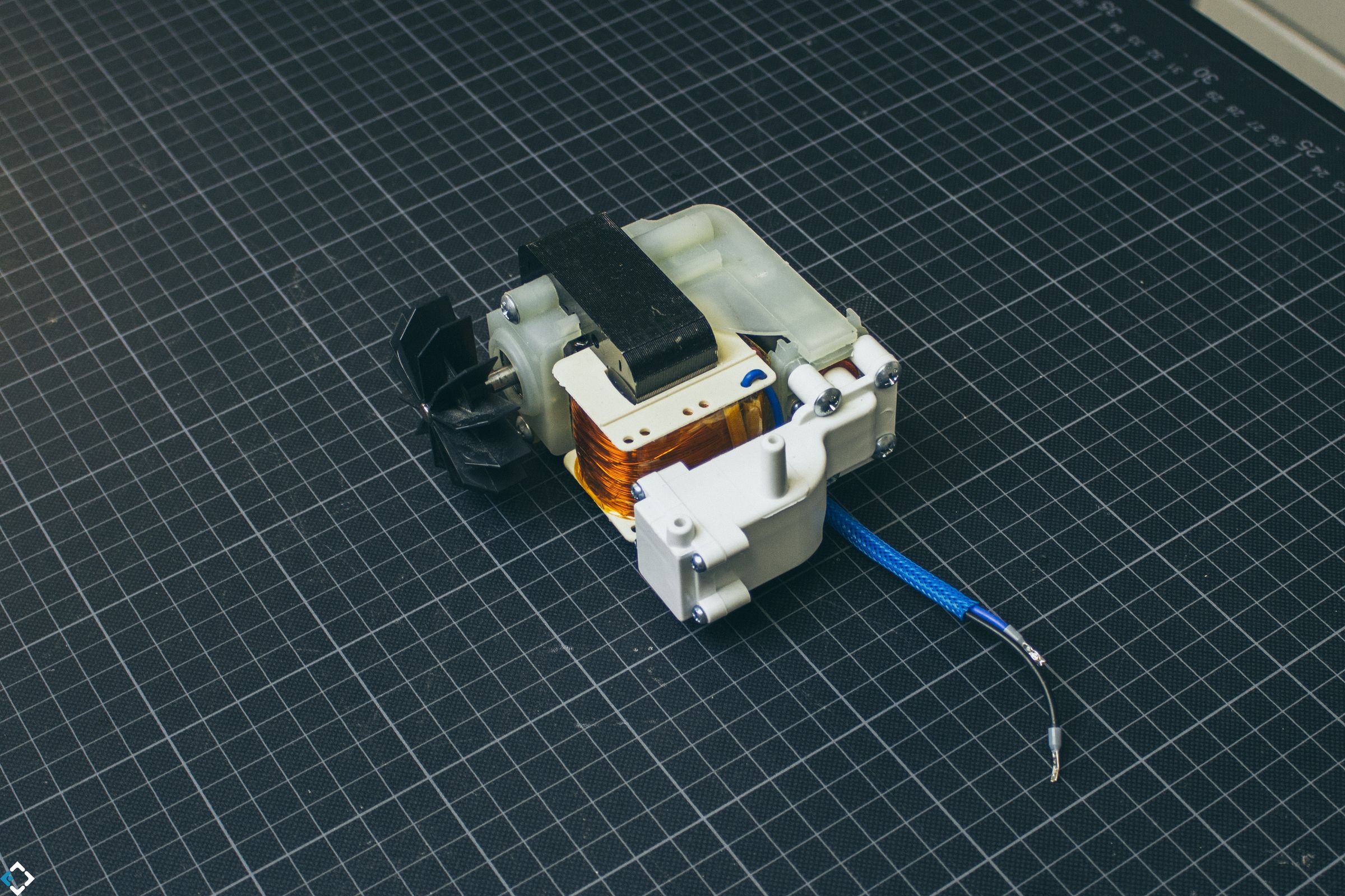

I bought a new inhaler for my children and took a closer look at the 5-year-old machine.
https://www.medisana.com/en/Therapy/Inhalers/?forc...

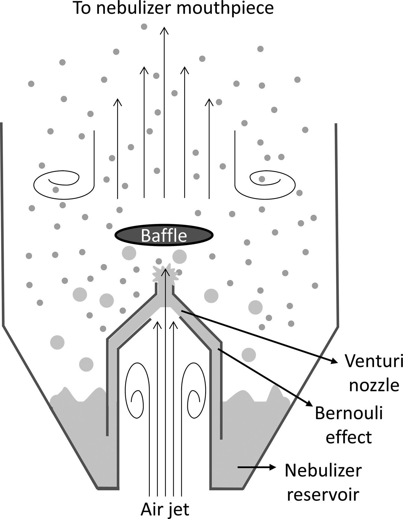

How does an inhaler work?
https://en.wikipedia.org/wiki/Nebulizer
Inside runs an AC shaded-pole motor that drives a reciprocating compressor.
https://en.wikipedia.org/wiki/Compressor
https://en.wikipedia.org/wiki/Shaded-pole_motor
The initial joy was quickly gone because this variant also creates a very fine mist that should not work for plants. However, I chose this variant. The size of the fog particles can be changed with different inserts. My hope is that with a modification of the insert you can change the size of the droplets.

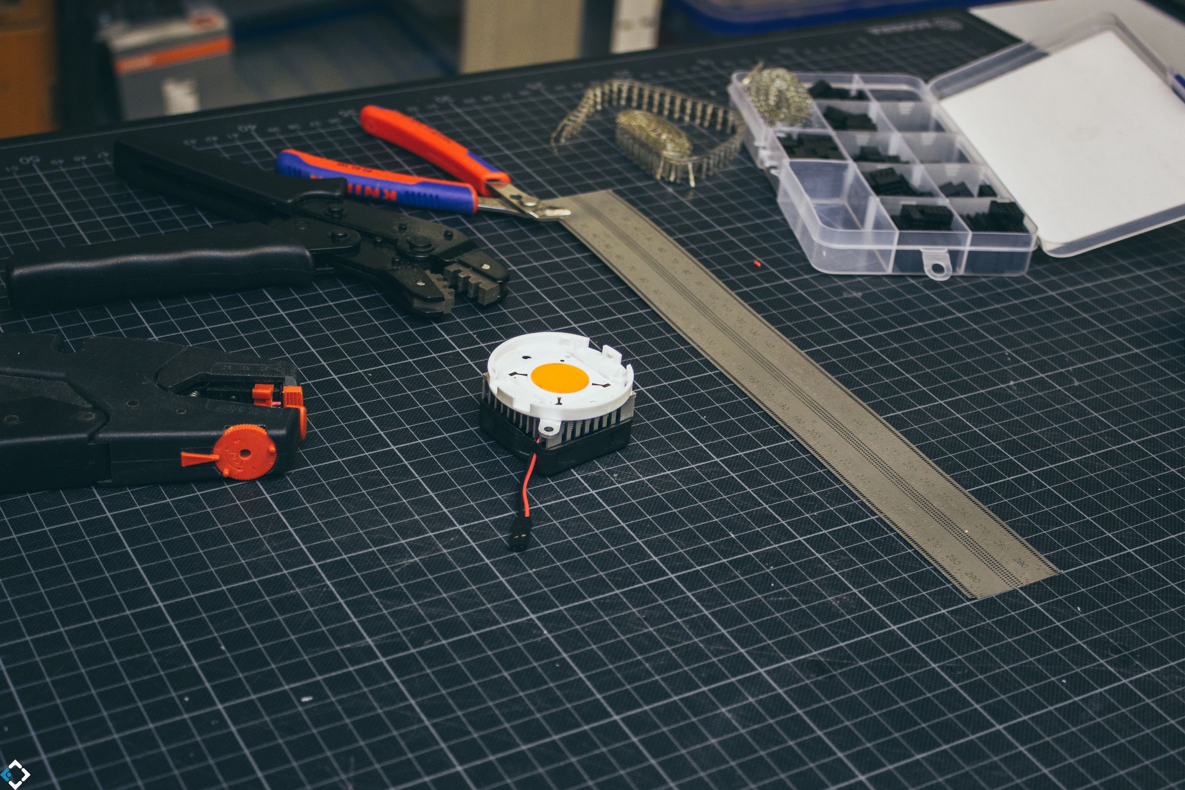

Light was another exciting topic where I learned a lot.
I chose a COB LED module that was specially developed for horticulture. The module also has a very wide range of PAR that can be accessed with the right cooling. In addition, all technically necessary data for this module is available online. Furthermore there is an excellent technical support, which helped me a lot.
I have calculated the whole thing to make sure that there is neither too little nor too much PPFD.
With this information you can calculate the DLI for a 12h ON / OFF time:
DLI at 11W = 259 µmol/sm² * 60 * 60 *12 = 11,19 mol/m²/d
DLI at 76,4W = 1306 µmol/sm² * 60 * 60*12 = 56,42 mol/m²/d (which is not possible in reality)

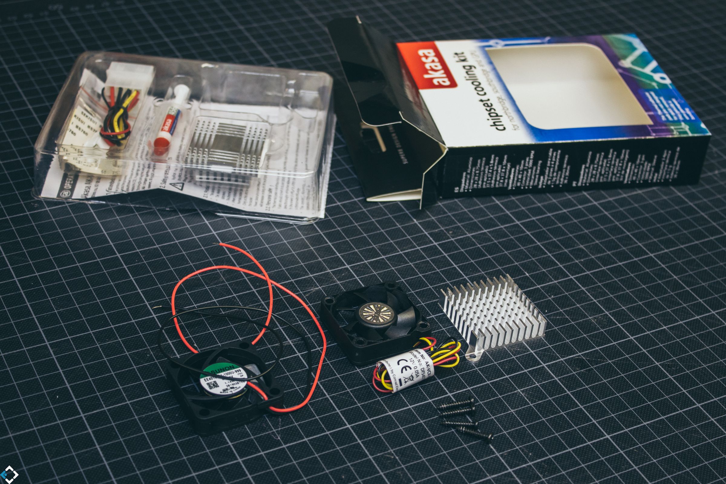

High performance LEDs require sufficient cooling.
Calculation:
Heat sinks with low thermal resistance are very large and therefore heavy.
But,...
there should also be air circulation in the system.
So why not kill 2 birds with one stone? Cool the LED actively and use the exhaust air for circulation. A possible further advantage is the heat in the exhaust air which could have a positive effect on the plants.

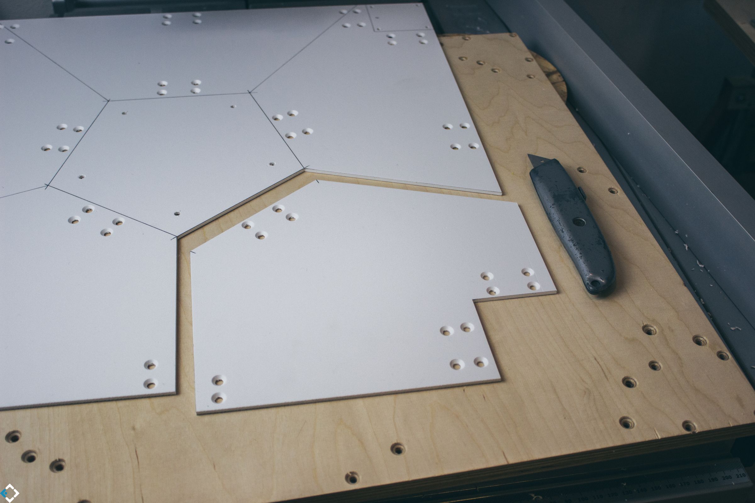

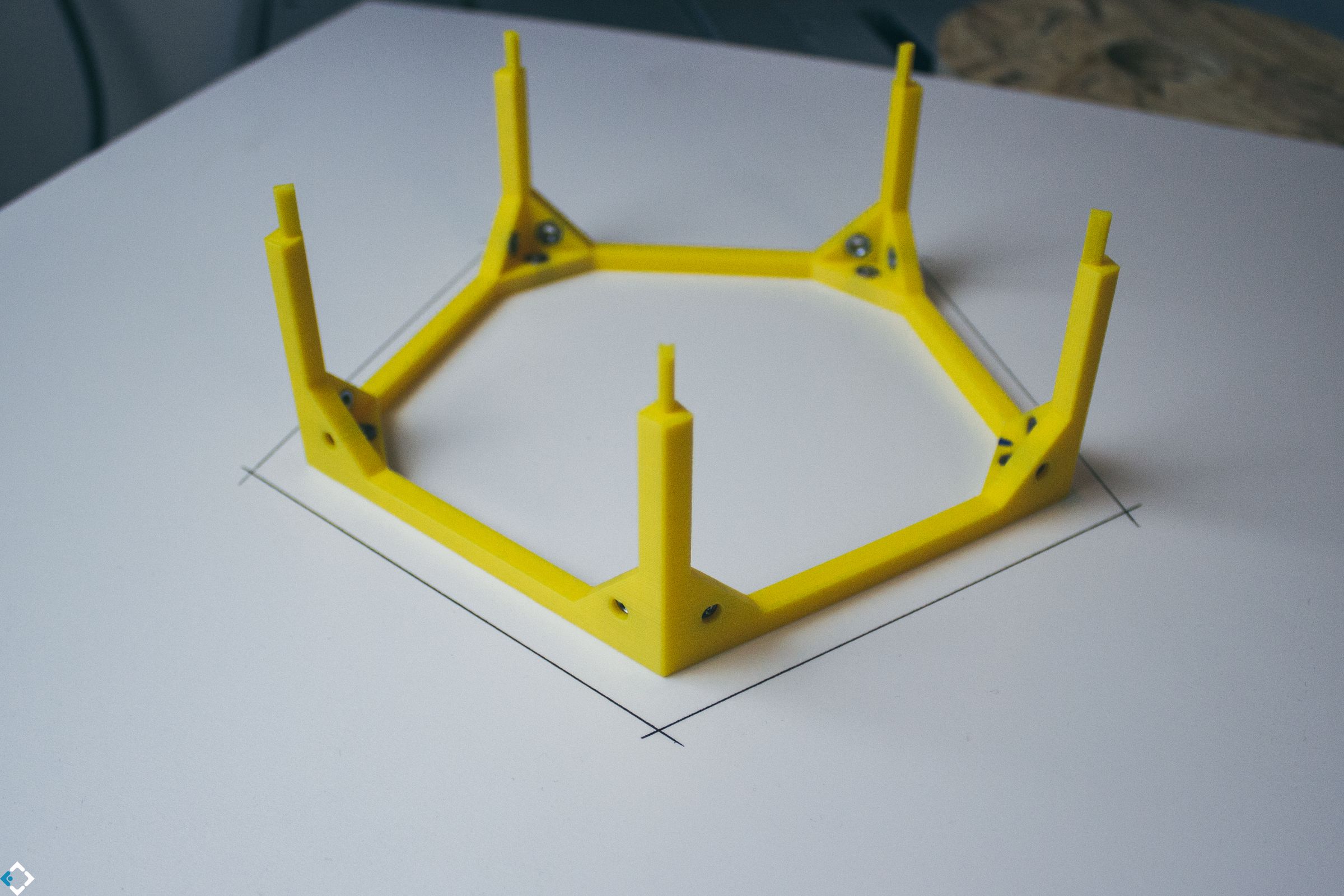

To get used to it, I built another prototype.
Mini dodecahedron, one plant per area
Enclosure for the shaded-pole motor and the reciprocating compressor.
In another prototype, I experimented with a variable spacer. In this variant, the height of the light module could be adjusted using a DC geared motor, bevel gears and a threaded rod. This would have allowed a variable alignment of the light to the plants. The cables would have to be routed via a drag chain.
I designed, printed and tested everything. It worked quite well.
But because of the additional mechanical and electrical components, I did not pursue this variant any further. Furthermore, in the installation space of 500x500x500 there is not much room for long travel distances.

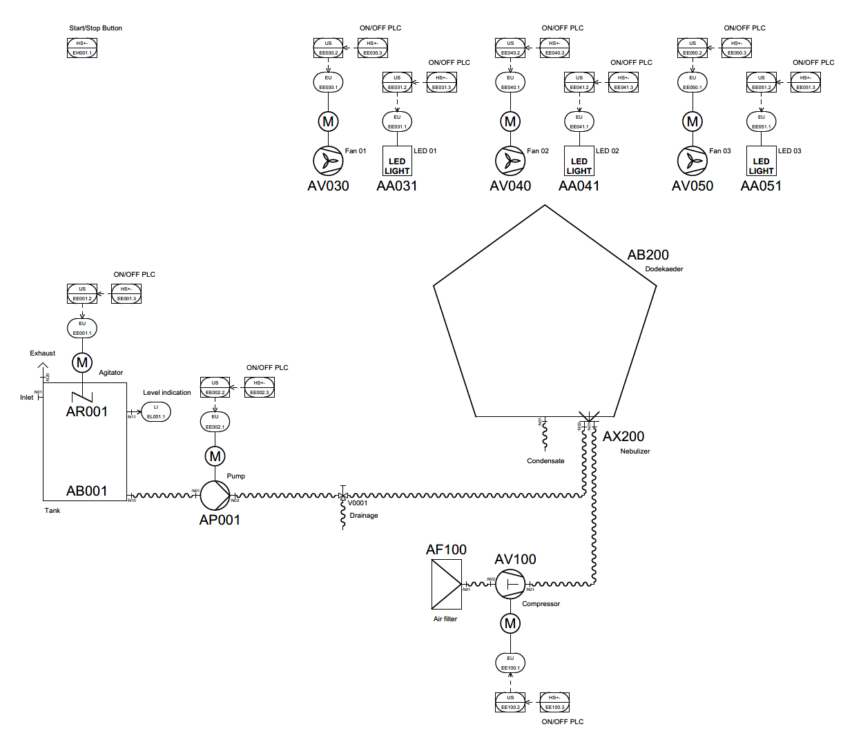

How does the system work?
It is a small and simple process system with the following components:
The P&ID diagram looks like this:
Description:
More information can be found in the "Electronics" and "Arduino Sketch" section.
A water-nutrient mixture is filled into Tank AB001 by means of a syringe. This is done via fillport N01. Existing air can escape from the outlet N02. The fill level of the Tank AB001 can be read manually on site (transparent tank).
The system can be started and stopped via a local EH001 Control Unit. The status is indicated via a local indicator light and a local display.
Everything works in Auto mode. No manual operation is possible.
Two step sequences control the entire system.
One sequence is responsible for the Light-cycle, the other one for the Hydro-cycle.
Hydro-cycle:
- The Tank AB001 is equipped with an Agitator AR001 that keeps the water-nutrient mixture in motion for 10 seconds to prevent solid particles from settling.
- The liquid in the Tank AB001 is pumped by an Pump AP001 for 5 seconds towards the Nebulizer AX200. In the event of a fault or special incidents, the 3-way valve V0001 can be operated manually to empty the Tank AB001 via the pump AP001.
- An Filter AF100 is used to suck in ambient air for the compressor AV100. Together with the liquid from AP001, it creates fog in the Nebulizer AX200 for 30 seconds.
The fog flows into the Dodecahedron AB200 and supplies the roots of the plants with water, nutrients and air.
Condensation water in the Dodecahedron can flow through an outlet.
The Hydro-cycle is controlled by timers to create a fog time of 30 seconds and a pause time of 120 seconds.
Light-cycle:
- The 3 Horticulture COB LED AA031, AA041 and AA051 as well as the 3 Fans AV030, AV040 and AV050 are switched on and off for a 12/12 cycle.

- 12V Heatsink/Fan + Fan

- 230V AC Shaded-pole motor + Compressor

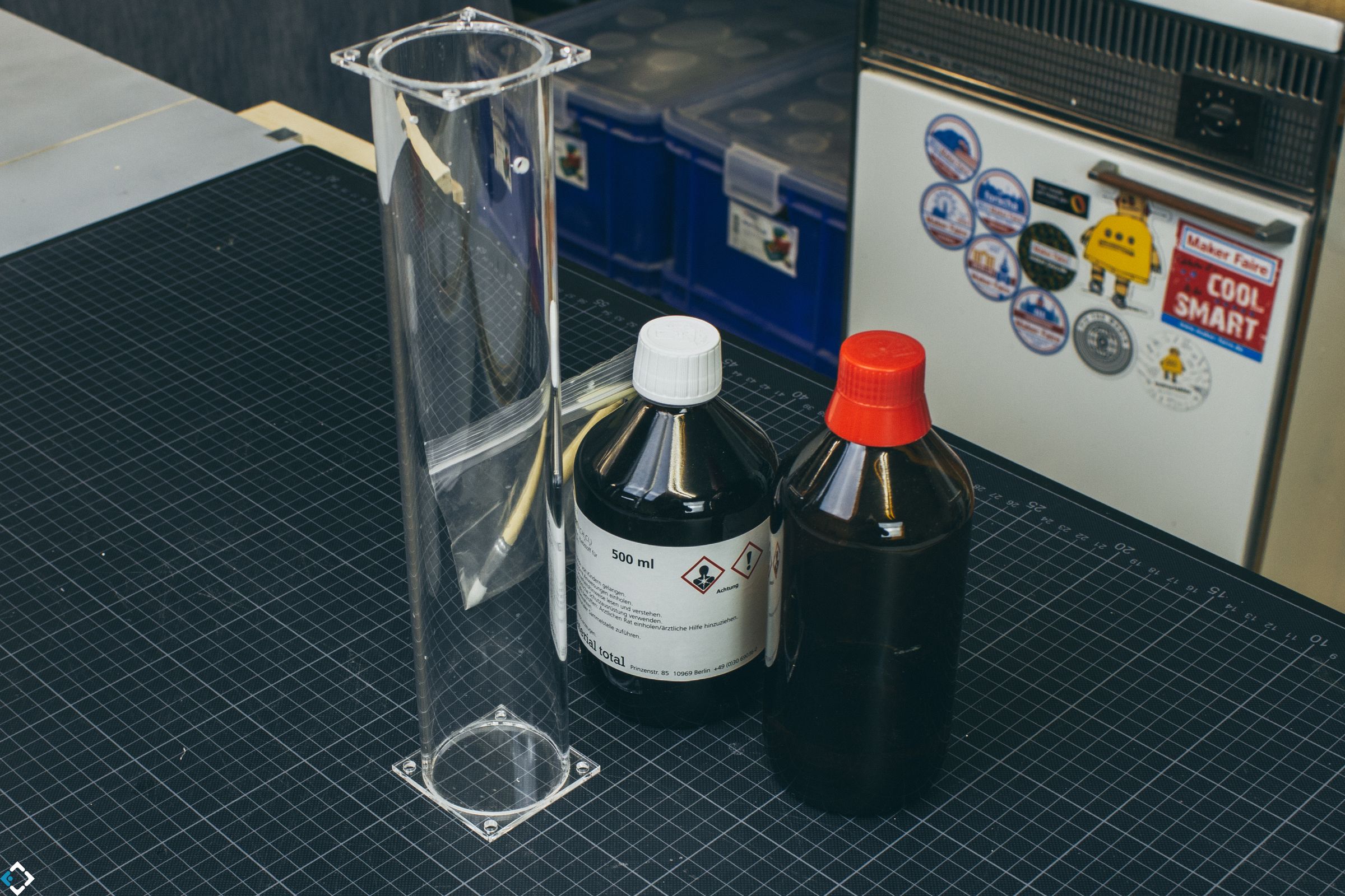

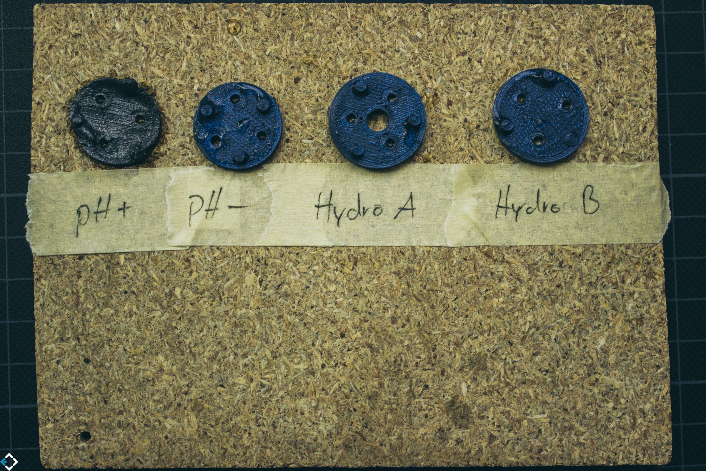

I subjected PLA filament to a material test over a period of 6 months. During this time the material was exposed to concentrated Hydro A, B, pH + and pH-.
Optical result:
Hydro A => Nothing has changed
Hydro B =>Nothing has changed
pH+ => Total destruction
Ph- => Nothing has changed

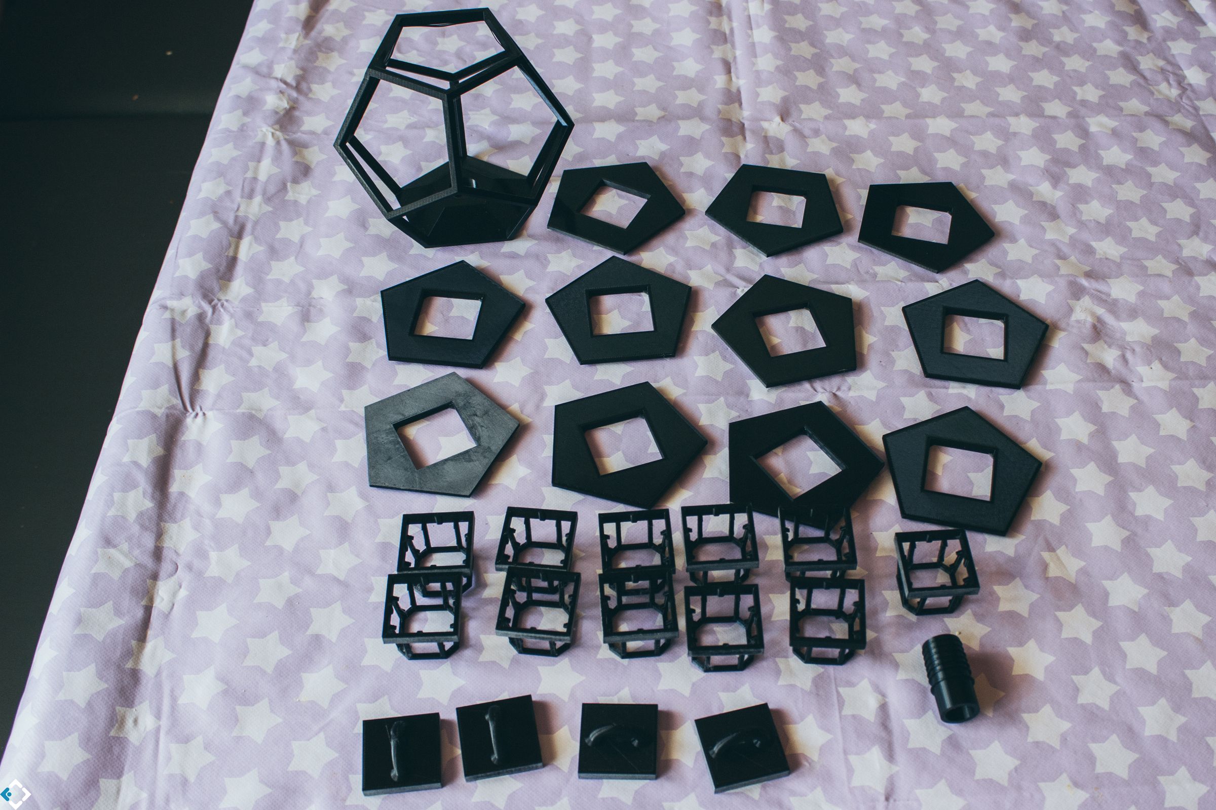

Step 7: 3D Printing
3D printing
3D printing was used very excessively in this project. Almost all parts are 3D printed.
The basic idea:
Print as many parts as possible directly on the space station. Not all parts need to be transported from the ground station. Spare parts are therefore no problem either. Currently, there is already a 3D printer on the ISS. Maybe a larger one in the future.

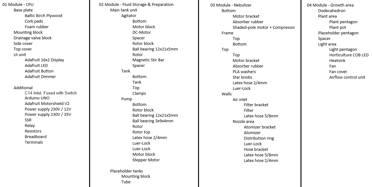

Step 8: The Modules
The Modules
Here you see an overview of the modules with all parts
Step 9: 01 Module - CPU
01 Module - CPU
The "01 Module - CPU" contains the central control unit and most of the I/O devices. In this area, the components are mounted and wired together. In addition, the module is the central base plate and the stabilization element of further construction. The electronic components are protected by covers. The central UI for the system is also mounted there.
It contains the following components:
- Base plate
- Baltic Birch Plywood
- Cork pads
- Foam rubber
- Mounting block
- Drainage valve block
- Side cover
- Top cover
- UI unit
- Adafruit 16x2 Display
- Adafruit LED
- Adafruit Button
- Adafruit Dimmer
- Additional
- C14 Inlet, Fused with Switch
- Arduino UNO
- Adafruit Motorshield V2
- Power supply 230V / 12V
- Power supply 230V / 35V
- Ssr
- Relay
- Resistors
- Breadboard
- Terminals

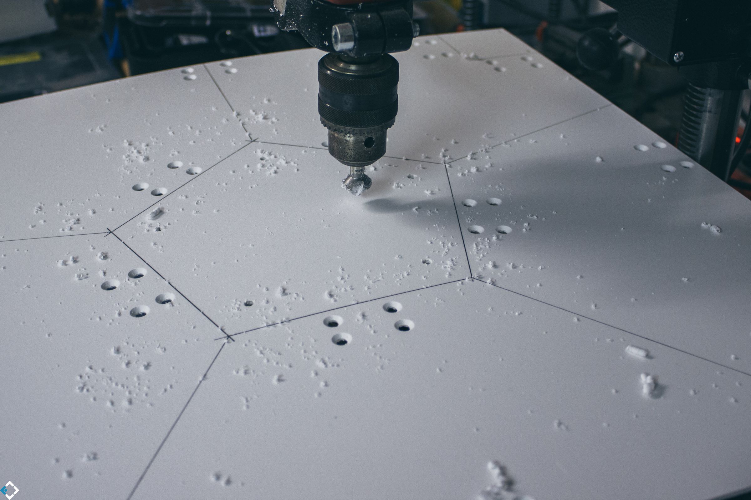

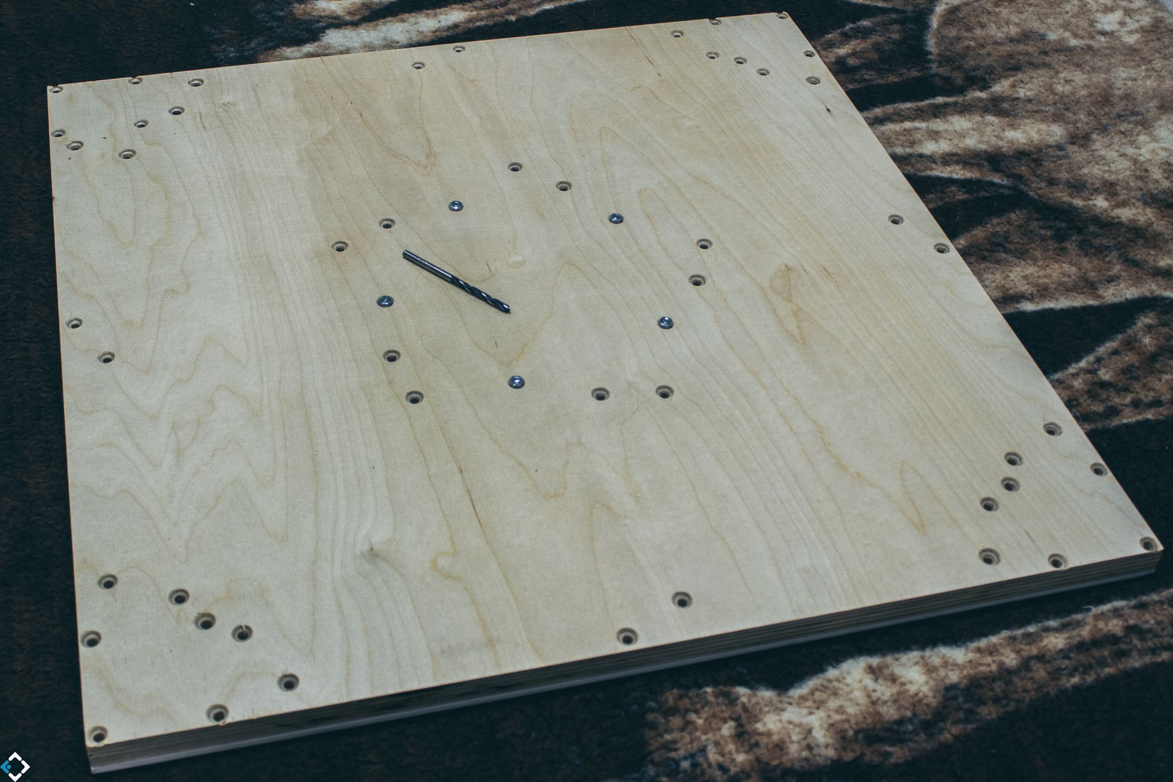

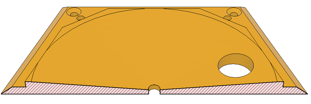

Step 10: 01 - Base Plate
Base plate
What is the component required for?
The first component of the CPU module is the base plate. It is the central mounting and stability element. The base plate consists of:
- 1x Baltic Birch Plywood
The wooden plate has numerous holes. These are used to attach other components, such as the Mounting blocks, Main tank unit or Nebulizer. - 14x Cork pads
The cork pads serve as dampers for the mechanical vibration of the compressor and are the feet of the entire construction. They also prevent slipping on smooth surfaces. - 1x Foam rubber
Like the cork pads, the foam rubber inlay serves as a damper for the mechanical vibrations caused by the compressor.
Where is the component located and how is it mounted?
Bottom of HOPE. - 14x Cork pads
The cork pads were glued to the underside of the wooden plate with wood glue. 8 in the outer area and 6 inside. - 1x Foam rubber
The rubber is placed in the middle of the Plywood plate.
How and from which material is the component made?
The Baltic Birch Plywood plate was cut on the table saw. Using a ruler and pencil, numerous markings from Fusion360 or directly with the help of the 3D printing part were transferred to the wooden plate. The holes were created with the hand drill, various drill bits, and a countersink bit. Finally, the surfaces and edges were sanded.
- 14x Cork pads
The circles for the feet were cut out of a cork plate with a paper circle cutter.
- 1x Foam rubber
The shape of the Nebulizer bottom + a 10mm edge was transferred to a piece of foam rubber and cut out with ruler and cutter.

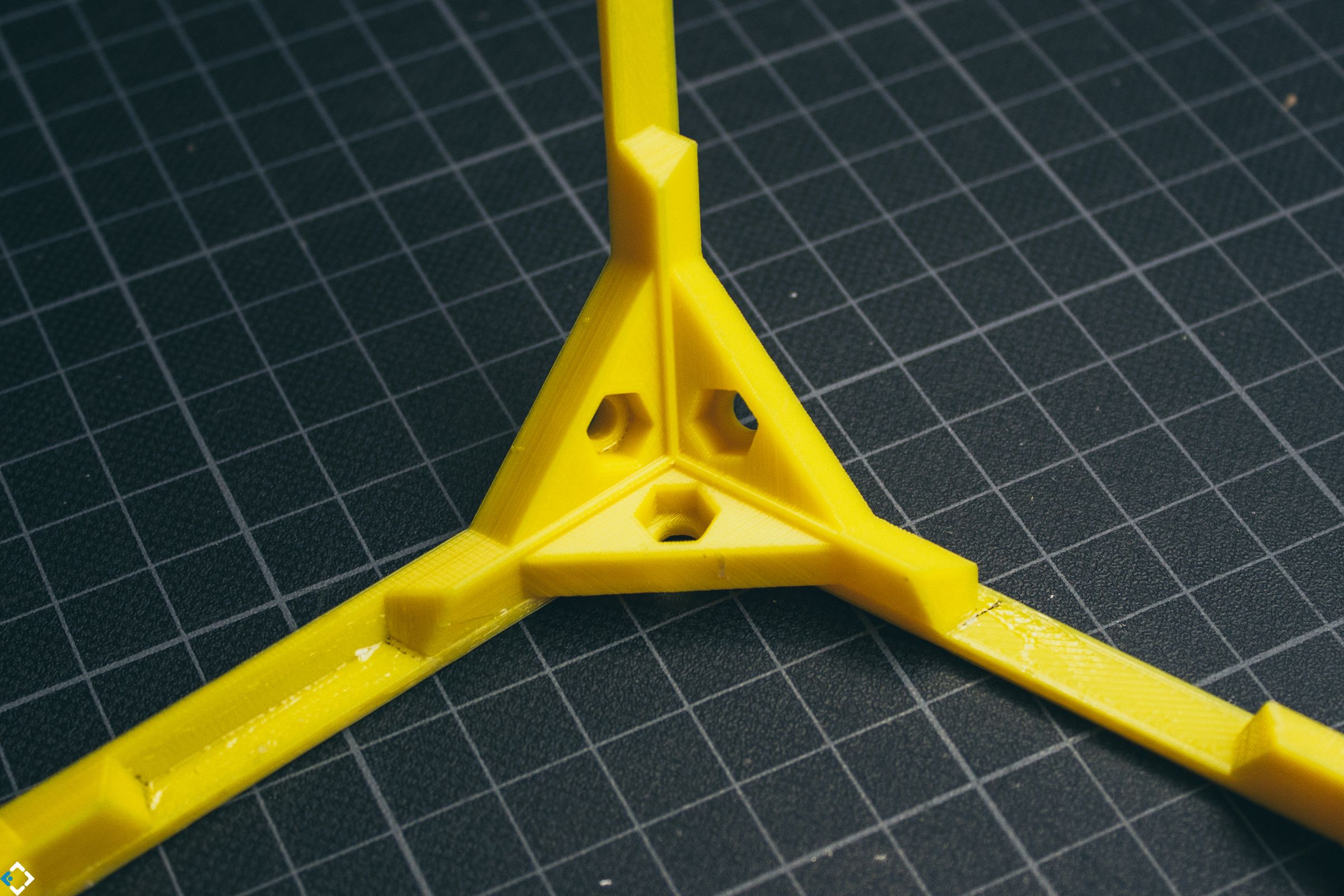

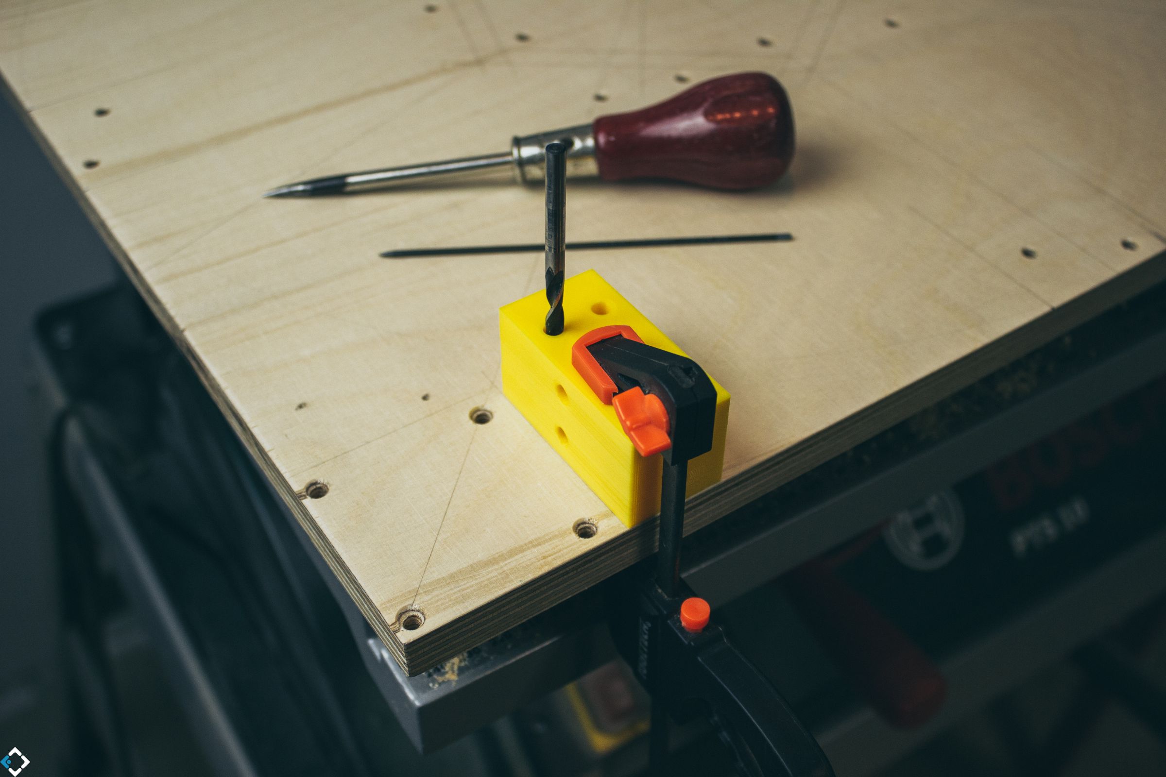

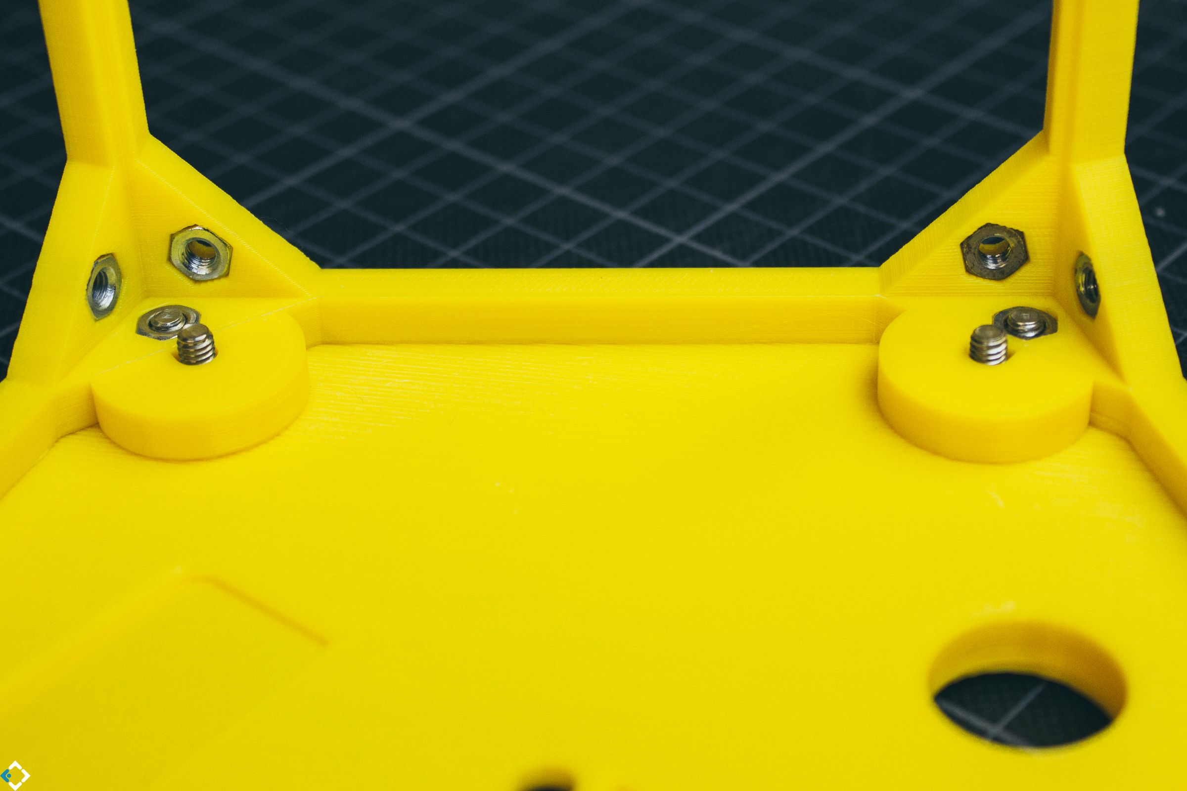

Step 11: 01 - Mounting Block
Mounting block
The Mounting block is the connecting element between the wooden panel and the Side and Top covers. It has 16 holes, so there are mounting options on all sides.

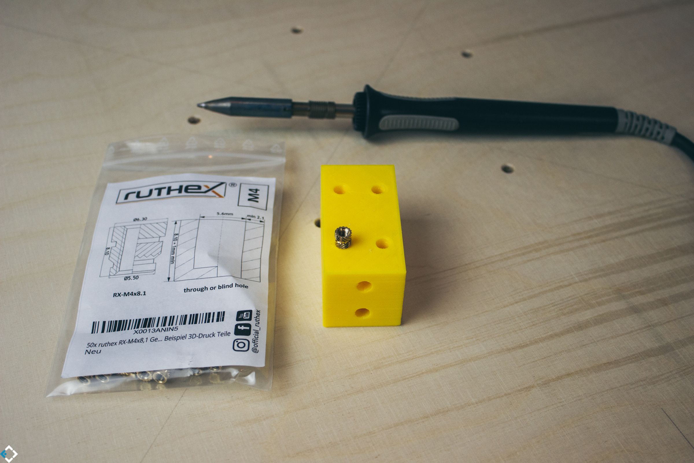

The Mounting blocks are screwed to the wooden plate. 8 pieces near the corners, 4 pieces at the edges of the plate and 5 near the Nebulizer.
Created in Autodesk Fusion360, sliced with Simplify3D and printed from Fillamentum TrafficYellow PLA. Ruthex M4 threaded inserts are pressed into the holes of the block. This is done with a soldering iron at 210°C. After a cooling phase, parts can now be attached to the block with M4 screws.

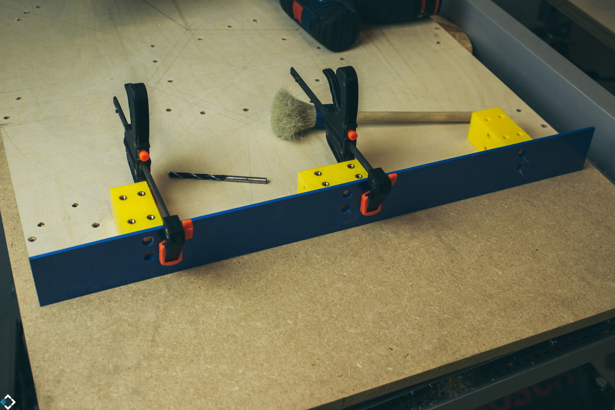

The side cover are screwed to the side of the Mounting blocks. They are flush with the base plate and with the top cover.
On the table saw I cut the 4 side cover. Afterward, I clamped them to the mounting blocks which were already mounted on the base plate. So I could mark the holes very easy and exact. They were drilled with the hand drill.

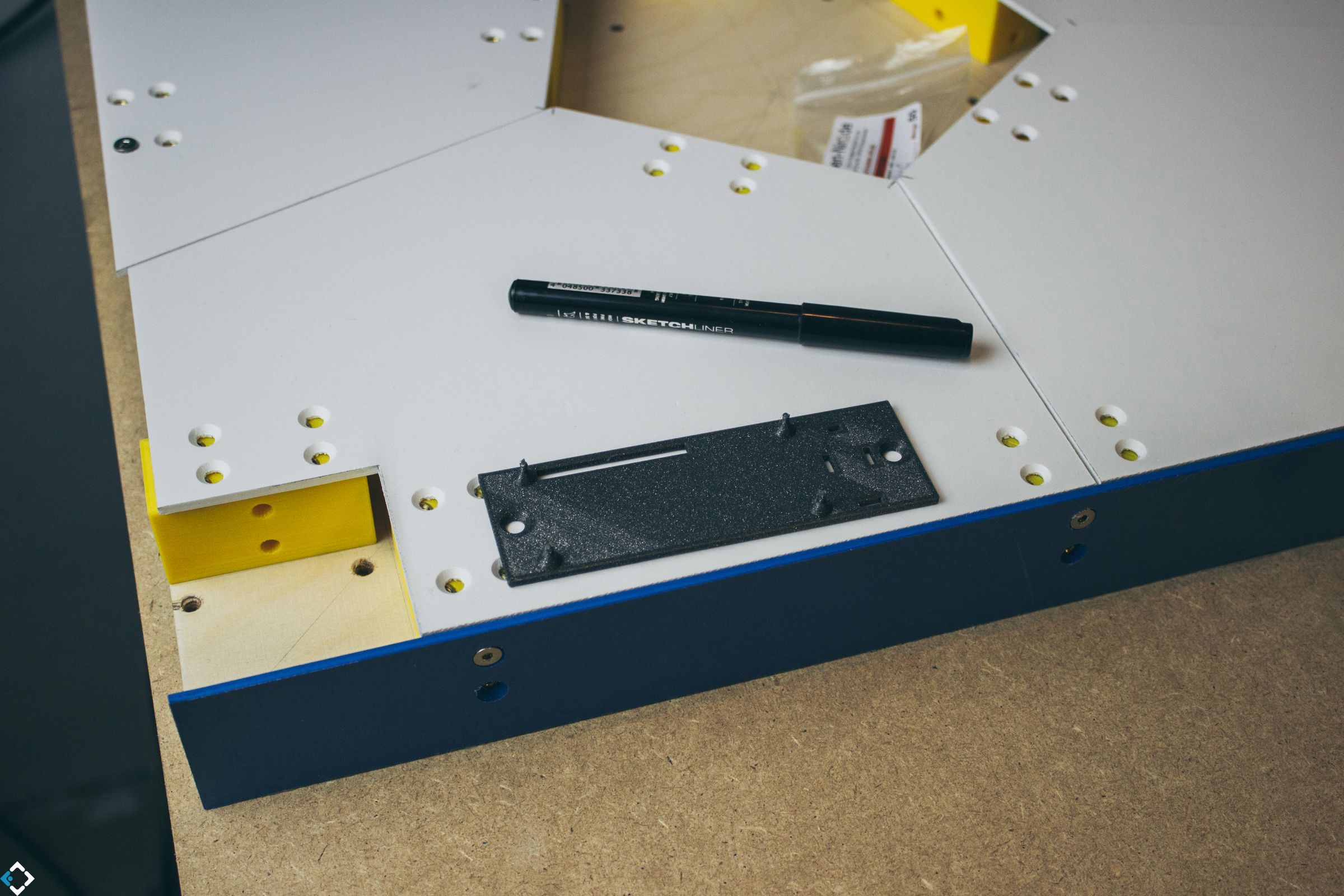

Similar to the Side cover, the main function of the Top cover is to cover and protect the electronic components installed underneath. Two of the covers have recesses for the UI elements. In the middle, there is a pentagon recess for the Nebulizer.
The top covers are screwed to the top of the Mounting blocks.
The plates are available for purchase in the dimensions 500x500mm. A cut was therefore not necessary. I clamped the polystyrene plate to the base plate and transferred all holes and the recess to it. All holes were made with the hand drill and drill press. Then I marked angle bisectors with 126 ° around the center. With a cutter and ruler, I cut the plate into 5 parts and also the recesses for the tanks, UI and C14 Inlet.

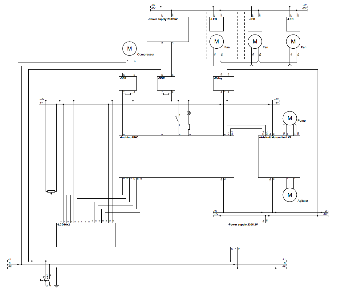

Step 16: 01 - Additional
Additional
Basic electronic components are needed to create simple automation. Some of these components are screwed directly onto the base plate. For more information, see the sections "General description and functional description", "Electronics" and "Arduino Sketch".
It contains:
- 1x C14 Inlet, Fused with Switch
230V Feed, which supplies the whole system. Built into a top cover. - 1x Arduino UNO
The central brain of HOPE - 1x Adafruit Motorshield V2
It is connected via I2C and controls the DC motor (agitator) and the pump (stepper) - 1x Power supply 230V / 12V
Power supply for Arduino, Motorshield, fan and other components - 1x Power supply 230V / 35V
It provides the voltage and current for the Horticulture COB LED - 2x SSR
The solid state relays are connected to the Arduino. They switch the 230 V for the shaded pole motor (Nebulizer) and the power supply 230/35 V on and off - 1x Relay
The relay is controlled by Arduino and switches the 12V for the fans on and off - 2x 10K & 1x 220 Resistors
Series resistors - Breadboards & Terminals

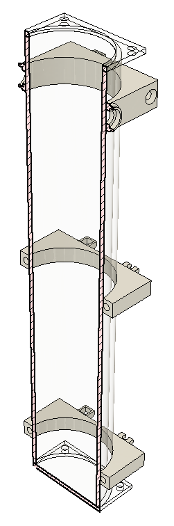

Step 18: 02 - Main Tank Unit
Main Tank unit

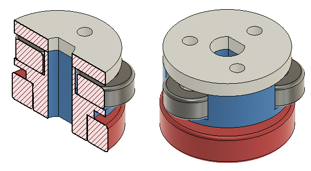

Step 19: 02 - Agitator
Agitator
Solid components may settle to the bottom of the vessel over time. To prevent this, the agitator stirs the fluid before pumping. It is a magnetic stirrer that generates a rotary motion in the liquid via 2 magnetic pills. The rotor is driven by a DC motor.
Parts:
- 1x Bottom
- 1x Motor block
- 1x DC motor
- 1x Spacer
- 1x Rotor block
- 1x Ball bearing 12x21x5mm
- 1x Rotor
- 1x Magnetic Stir Bar
- 1x Spacer
The individual parts of the agitator are placed on top of each other and held in position by screws. The agitator itself is screwed into one of the corners of the base plate and below the tank.
The various items were created in Autodesk Fusion360, sliced with Simplify3D and printed from 3DJake ecoPLA Matt White. The ball bearing was pressed into the rotor block. The rotor was fixed in the ball bearing and the magnetic pill in the rotor with 2K epoxy.
Step 20: 02 - Tank

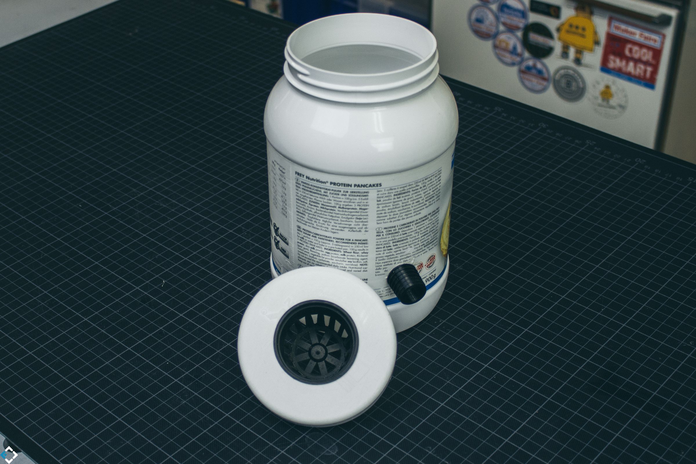

Tank
The tank contains the fluid required for the Nebulizer. 3 clamps on the Tank serve as hose and cable guides to the base plate. The upper bracket also contains the fillport with Luer-Lock connection and the vent.
The tank consists of several parts:
- 1x Bottom
- 1x Tank
- 1x Top
- 3x Clamps
Where is the component located and how is it fixed?
The clamps are clamped to the tank with screws at regular intervals. The tank is screwed onto the Agitator, which is located in one of the corners of the base plate.
The clamps were created in Autodesk Fusion360, sliced with Simplify3D and printed from 3DJake ecoPLA Matt White. Two Ruthex threaded inserts were melted into the clamps using a soldering iron. With fine sandpaper the edges of the plexiglass tube were sanded flat, cleaned with ethanol and glued to the bottom and top with dichloromethane. The bottom and the top have 4 holes into which the agitator and the pump can be screwed.

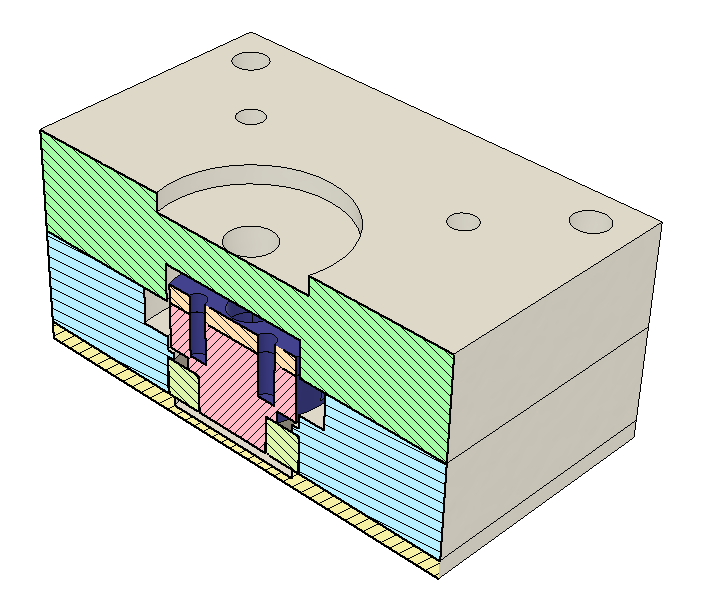

Step 21: 02 - Pump
Pump
The pump transports the liquid from the tank into the nebulizer. The peristaltic pump is powered by a stepper motor. A rotor squeezes a latex hose in a rotational motion, which leads to the conveying of the liquid.
Components:
- 1x Bottom
- 1x Rotor block
- 3x Ball bearing 3x9x4mm
- 1x Rotor
- 1x Rotor top
- 1x Latex hose 2/4mm
- 2x Luer-Lock
- 1x Motor block
- 1x Stepper Motor
The individual parts of the pump are placed on top of each other and held in position by screws. The pump sits above the tank and is screwed to it.
Very similar to the agitator, the pump was created in Autodesk Fusion360, sliced with Simplify3D and printed from 3DJake ecoPLA Matt White. Three ball bearings are placed on the pins of the rotor and then screwed with the Rotor top. The rotor is glued into the ball bearing with 2k-epoxy. The ball bearing itself was pressed into the rotor block.
Step 22: 02 - Placeholder Tanks
Placeholder tanks
I only installed one tank in the system. Since I did not want to leave the other areas open, I created placeholder tanks.
Parts:
- 6x Mounting Block
- 3x Tubes
The placeholder tanks are located in the corners and are screwed directly onto the base plate. The exception is the small placeholder tank, which is located above the main tank.
The Mounting blocks were built in Autodesk Fusion360, sliced with Simplify3D and printed from 3DJake ecoPLA Matt White. The tubes are cardboard tubes that I cut on the Miter saw. I covered them with a white carbon foil. The tubes are pushed into the Mounting blocks.
Step 23: 03 Module - Nebulizer
The "03 Module - Nebulizer" is responsible for the atomization. With liquids, from the module Fluid Storage & Preparation, and compressed air a mist is generated, which flows into the next module.
Components:
- Bottom
- Motor bracket
- Absorber rubber
- Shaded-pole motor + Compressor
- Frame
- Top
- Bottom
- Top
- Top
- Motor bracket
- Absorber rubber
- PLA washers
- Star knobs
- Latex hose 2/4mm
- Luer-Lock
- Walls
- Air inlet
- Filter bracket
- Filter
- Latex hose 5/8mm
- Nozzle area
- Atomizer bracket
- Atomizer
- Distribution ring
- Luer-Lock
- Hose brackets
- Latex hose 5/8mm
- Latex hose 2/4mm
Step 24: 03 - Bottom

Step 29: 03 - Nozzle Area
Nozzle area
This is where one of the important actions takes place. Liquid and air become mist. Liquid enters the Nebulizer from above via a pump. Compressed air from the compressor flows from below into the Nebulizer. The hoses are guided safely via brackets.
Components:
- Atomizer bracket
- Atomizer
- Distribution ring
- Luer-Lock
- Hose bracket
- Latex hose 5/8mm
- Latex hose 2/4mm
- Atomizer bracket
The bracket is screwed to the inside of the wall - Atomizer
The atomizer is inserted into the bracket from above - Distribution ring
It is placed on the Atomizer. - Hose mount
Glued to the wall with Acrifix. - Latex 5/8mm
Air hose is connected to the atomizer at the bottom - Latex 2/4mm
Liquid hose is connected to the distribution ring
Bracket, distribution ring and hose mount were created Autodesk Fusion360, sliced with Simplify3D and printed from 3DJake ecoPLA Matt Grey and Matt White.
Step 30: 04 Module - Growth Area
04 Module - Growth area
In the "04 Module - Growth area" the real magic happens. This is where the plants grow. The main feature is the dodecahedron. With its 11 sections, up to 33 plants can grow. The roots extend inwards into the dodecahedron, where they are supplied with water, nutrients, and air in the form of mist. The light area is attached via a fixed spacer, which provides light and air circulation for the plants.
The module consists of
- Dodecahedron
- Plant area
- Plant pentagon
- Plant pot
- Placeholder pentagon
- Spacer
- Light area
- Light pentagon
- Horticulture COB LED
- Heatsink
- Fan
- Fan cover
- Airflow control unit
Step 31: 04 - Dodecahedron
Dodecahedron
The dodecahedron is the central element of the growth area. Different modules can be attached to 11 places. In the interior, there is space for the roots of the plants.
The dodecahedron is located directly above the Nebulizer module and is attached to it by Star knobs.
Due to the size, I had to split the dodecahedron to fit on the print area of my printer. Afterward, the parts were glued together again with Acrifix. I spent a lot of time adding hex nuts to the construction. In retrospect, this was a very good idea and saved me a lot of time and trouble. They were melted into the prepared recesses with a hot air gun at 210 ° C.
Step 32: 04 - Plant Area
Plant area
In the plant area, the seedlings are screwed in with their pot and remain here until harvest.
The plant area consists of:
- 1x Plant pentagon
The plant pentagon serves as a mounting possibility for 3 Plant pots. Cables and hoses can be routed along the edges. The Spacer is mounted in a recess. - 3x Plant pot
The EazyPlugs contains seedlings.
- 1x Plant pentagon
The plant pentagon is screwed onto the dodecahedron at the 11 places. - 3x Plant pot
The plant pots are screwed into the plant pentagon. After insertion, the EazyPlug is secured against slipping by barbs in the pots.
Plant pentagon and plant pot were created in Autodesk Fusion360, sliced with Simplify3D and printed from 3DJake ecoPLA Matt White and Glitter Grey. Hex nuts were melted into the prepared recesses with a hot air gun at 210 ° C.
Step 33: 04 - Placeholder Pentagon
Since not all 11 places in the dodecahedron are needed, pentagon placeholders are used for closing.
The placeholder is placed on the dodecahedron and screwed down.
The shape of a plant holder was transferred to a piece of polystyrene. The shape was cut out with a ruler and cutter. The mounting holes were drilled with a hand drill.
Step 34: 04 - Spacer
Spacer
The spacer creates a distance between the plant area and the light area. It also serves as a cable guide.
The spacer is screwed between the plant and the light area.
The spacer was created in Autodesk Fusion360, sliced with Simplify3D and printed from 3DJake ecoPLA Glitter Grey. At both ends, M4 hex nuts were melted in with a hot air gun
Step 35: 04 - Light Area
Light area
In the light area is the lighting of the plants. The exhaust air from the active cooling of the LEDs is reused for the air circulation of the plants below. This can be controlled via sliders.
The light area consists of:
- 1x Light pentagon
There are recesses for LED, heat sink, exhaust air, and the spacer. - 1x Horticulture COB LED
Creates the necessary lighting for the plants - 1x Heatsink
As this is a high-power LED, cooling is absolutely necessary. The exhaust air is released into the environment via the heat sink - 1x Fan
Improves the thermal resistance of the heat sink by supplying additional air - 1x Fan cover
The fan cover is the housing for the heatsink and fan. It is also the first part of the Airflow control unit. The exhaust air can be controlled in certain directions via built-in slots. - 1x Airflow control unit
The exhaust air can be controlled via 3 sliders. When all are closed, no air reaches the plants. The exhaust air is then released into the environment.
- 1x Light pentagon
It is screwed to the spacer. - 1x Horticulture COB LED
The LED is located in the middle of the light pentagon. It is attached to the heat sink with a heat-resistant and heat-conductive adhesive. - 1x Heatsink
The heat sink has 2 tabs with holes. These are inserted via 2 pins in the middle of the light module and thus fixed. - 1x Fan
The fan is screwed into the heat sink with 4 screws. - 1x Fan cover
It is plugged into the combination LED, heat sink and fan and screwed directly to the light pentagon. - 1x Airflow control unit
The Airflow control unit is screwed to the pentagon from below. The sliders are inserted into the brackets from the front.
Light pentagon, Fan cover, and Airflow control unit were created in Autodesk Fusion360, sliced with Simplify3D and printed from 3DJake ecoPLA Matt White and Glitter Grey. M4 hex nuts were melted in with a hot air dryer.

Step 37: Electronics
Electronics
More information can be found in the "General and Functional Description", "Module 01-04" and "Arduino Sketch" section.
Currently, with a few exceptions, everything is mounted on the base plate. If not all tanks are needed, components could be installed there.
To minimize the chaos, I made many cables and equipped them with wire ferrules or DuPont plugs and sockets. As far as possible I packed the wires into a flexible sleeve.
The cables for light and fan lead through the cable ducts via the Nebulizer into the Growth area. The cable for the Stepper Motor (Pump) is led along the tank to the base plate.
I use the following components:
- 1x Arduino UNO
- 3x Horticulture COB LED
- 3x 12V Fan
- 2x SSR
- 1x Relay
- 1x 230V AC Shaded-pole motor + Compressor
- 2x 10K Resistor
- 1x Adafruit Button
- 1x Adafruit LED
- 1x 220 Resistor
- 1x DC Motor
- 1x Adafruit Stepper Motor
- 1x Adafruit 16x2 Display + Dimmer
- 2x Breadboard
- 2x Terminals
They are wired according to the following diagram:

- Clean up voltage levels. Maybe everything is possible with 12V?
